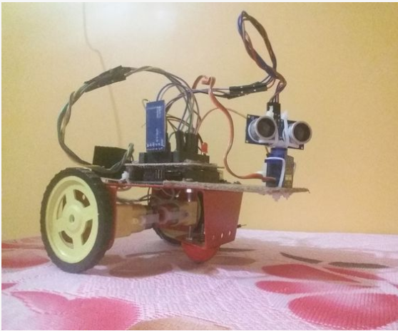

Originally, the idea of the DUO BOT was something different but due to the lack of time for testing, I decided to try my Idea with something basic i.e. a combination of Obstacle Avoiding bot & a Bluetooth controlled bot. And to my luck , the Idea worked very well.

Step 2: ASSEMBLING THE CHASSIS :
STEP 1:
Attach the geared motor to the robot chassis using a couple of nuts and bolts.
STEP 2:
Fix the caster wheel in the chassis using a pair of nuts & bolts.
STEP 3:
Attach the wheels of the motor using a pair of screws.
Step 3: FIXING THE ELECTRONIC COMPONENTS TO THE CHASSIS :
STEP 1:
Fix the Arduino UNO microcontroller on the chassis using Zip ties.
(I used zip ties as it was easy to fix and use . You can also use nuts & bolts instead.)
STEP 2:
Fix the L298n motor driver on the chassis using Zip ties.
STEP 3:
Attach the servo motor in front of the chassis using a pair of screws.
Try to fix the servo as near as possible to the edge of the chassis as it will work more efficiently in detecting the obstacle and sending the signal back to the Arduino.
STEP 4:
Fix the HC-sr04 ultrasonic sensor on top of one the servo mounts using a pair of zip ties and screw the servo mounts on top of the servo motor.
STEP 5:
Fix the HC-05 bluetooth module on the robot chassis.
Actually I had fixed it on the Arduino expansion shield which I had made earlier.
