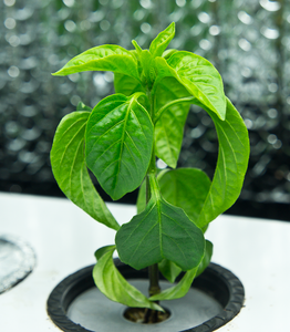

Now we're growing!
Here's the latest pictures of my active system (the uploaded video below was taken approx 1.5 weeks before these photo's). The pictures above show how I have thinned out my tomatoes (removed all but the 2 strongest growers). I have also harvested 1 complete basil plant, and pulled another from the system as it was not growing as strongly as its neighbour. The strongest basil plant had a cutting taken from it ~1 week ago and seems to be rooting nicely inside the rockswool cube. I have started sprouting 4 more basil plants but I am hoping my cutting will establish strong roots in the next few weeks and give me a jump start (growing from seed is slow).
