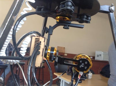

Step 1: Assembly the Free Axis Stabilizer (Gimbal)
The gimbal provide stabilization and free of motion in order to controller the system.
First, you need to assembly the Gimbal because usually the manufacturers ship you the device unarmed.
In this step you have to be careful with connection point of the motors, in order to prevent short circuit.
For calibrate the Gimbal you could use this instructable https://www.instructables.com/id/Gimbal-Calibration...
The gimbal is powered by EVVGC controller. This controller is used to stabilized the gimbal and you can positioning the camera. This is possible using the RC mode and the micro arduino. This device gives to the microcontroller a servo signal, and the signals are obtained by the Xbee. Moreover, the arduino also give the signal to shot the camera (more information in the next step).
