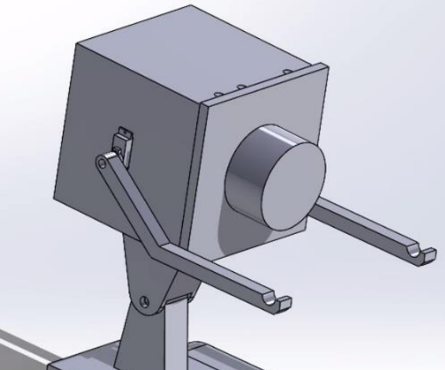

  1. Attach the Arduino and the breadboards to the chassis.
  2. Hot glue the motors to the bottom of the chassis opposite of each other and attach the wheels.
  3. Wire the motors and motor controllers into the Arduino using the wiring diagram.
  4. Attach the top printed part, while mounting the 2nd breadboard with the ultrasonic distance sensor and IR sensor also using the wiring diagram
  5. Attach the swivel wheels.
  6. Mount the line sensors to the front of the car pointing towards the ground.
  7. Download the file containing the code to the Arduino.
  8. Connect your computer to the car and upload the code.
  9. Disconnect computer and attach battery back to Arduino.
  10. Control the car with the IR remote
  11. Run and have fun.
