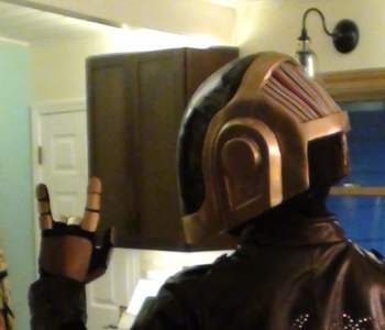

Introduction: Daft Punk Guy-Manuel Full Costume Build
I am by no means a professional. I do this because i love to build things, not because i am good at it. Honestly, most of this project was fixing problems because of things i did that i had no clue how to do. That said, this whole project cost me about $150. There are a lot of things i would change for next time, and i have included them in this instructable so that you don't make the same mistakes I did. Have fun building!
The jacket and gloves are at the bottom as well as more pics of the finished product.

For the padding, I went to House of Foam in Palo Alto and bought a strip of foam seen in the pictures for a buck (so went my budget at that point).  This was on Friday, and the deadline was Monday.  I made it, but just barely.  At this point, I also attached the visor with hot glue.  Make sure none of it shows on the outside.  We decided to also do the Alive 2007 Encore Version of the helmets as well, which I'll cover in the next step.
Step 18: Alive 2007 Encore Version
To do this, we basically wrapped the EL wire around the key highlights of the helmet and attached them with hot glue.  This looked really messy, so either don't use a lot of hot glue or find another way to attach them.  On Guy's helmet, we drilled holes in the ears, the inner ear design area, and the top of the visor.  On Thomas's helmet, I drilled holes in the ear and right above the ear.  And that's how you make the helmet!  But that's not the whole costume! Next up are the gloves.

Step 21: Finished!
There you go!  That's how i made my Daft Punk costume!  It took about 3 months to do, so if you dont have a lot of patience, i wouldn't recommend this project for you.
