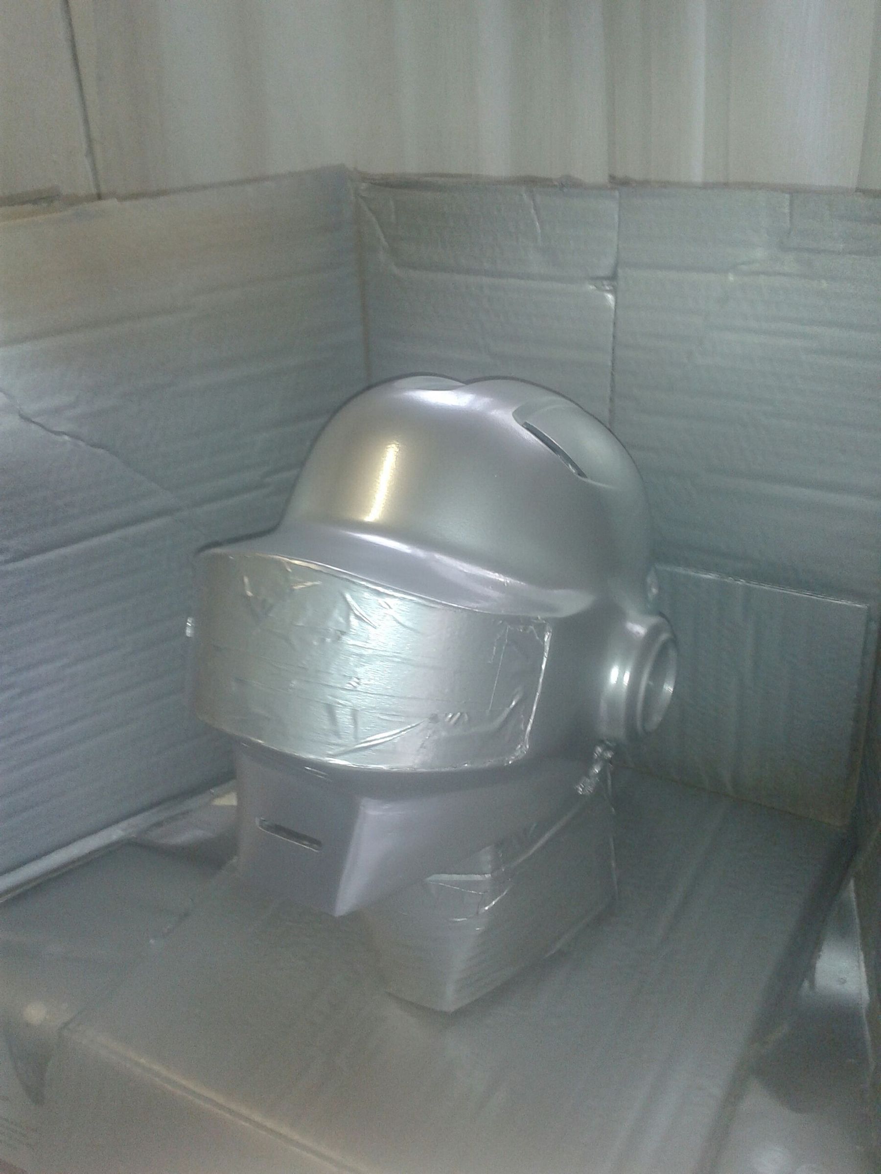

next spray helmet in satin black which should help you get that deep shine once the chrome plasticoat spray is applied ...
Step 12:
using a scrolling led belt buckle which i also got from amazon hot glue into position and glue a support in ...
Step 13:
once again remask visor and spray plasticoat chrome spray on evenly in light coats every 20 mins for desired effect . This is currently where i am at its very nealry done i shall make a final instructable when im finished .
