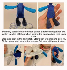

Note: All body/sword construction stitching is done with double-threaded polyester sewing machine thread. Switching thread colors between each color is recommended for blending effect.

Step 12:
Step 13:
Step 14:
Congrats! Your Dalu is done!
