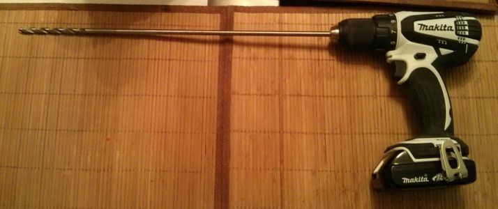

Tools -
Cordless Drill
18" x 5/16" drill bit (3/8" would have been better)
Headlamp
Cordless Drill
Headlamp

Hitting a cooling line inside the refrigerator wall or cooling plates inside the refrigerator is to be avoided. I settled on the final location by googling and checking with hand for absence temperature difference (indicating a nearby cooling line underneath the metal skin).
The drilling was done inside to outside, to provide near clearance to the cooling plates and other hardware. The long drill bit made this job very easy, I could see a problem using a shorter drill bit as the walls are thick and not much room for drill clearance.

The hole was drilled 5/16", I had to open it up to around 3/8" for free clearance. TheC O2 line was pushed through, outside -> inside then connected to gas T.
