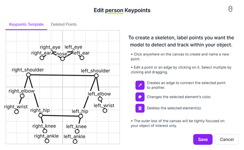

I started by creating a new project and setting up a key points template (see attached images). I followed the COCO template, which includes 17 key points for accurate pose estimation.

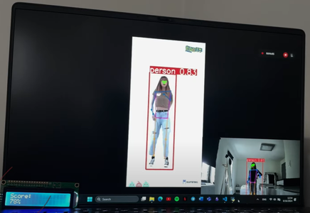

This is the main function for my game. I definitely learn a ton about how to work with videos while creating it! This function is designed to handle both the video and audio playback for the game, as well as overlaying the webcam feed and calculating the player's performance score. Here is the breakdown of what is happening there:
- Loading Data: First, I load the key points data from a pickle file and initialize video capture object for both the choreography video and the webcam.
- Audio Setup: Then I use Pygame library to initialize and play the audio that goes with the dance video. I sync it with the video in the main while loop.
- Display Setup: The function sets the application to run in full-screen mode for a better user experience. I also get the frame rate of the main video to sync the video and audio correctly later.
- Main While Loop: While the video and webcam are open, I keep doing the following steps:
- Get the current playback time of the audio.
- Calculate the corresponding frame number in the video.
- Read frames from both the video and the webcam.
- Mirror and resize the webcam feed.
- Use the model to predict key points from the webcam feed.
- Overlay the webcam frame on the main video frame.
- Display the combined frame in a window.
- Performance Scoring: Every 12 iterations, I calculate a similarity score between the key points from the video and the webcam by getting the normalized x,y coordinates from the key points objects and comparing them.
- Cleanup: After the loop ends, I release all resources, close files, and calculate the final performance score. This final score is written down in a separate csv-file that I created to create a scoreboard later.

Step 6: Extra: LCD Display
Here's a fun challenge: try connecting a Raspberry Pi to your application! I did it as part of my project requirements, and it definitely added a cool factor to my game.
I used the Raspberry Pi to display current performance scores on an LCD screen. During my second semester, I have created a whole class for displaying text on LCD, so I just copied it to the project repository. Essentially, this class handles the sending of data with the right instructions to the display using I2C bus. I learned all about it from the Sensors and Interfacing course, which is a part of the programme for my first year, so I legally can't share the learning materials here. However, you can use an existing library to operate an LCD display, as shown in this tutorial.
To display performance scores on LCD, however, I had to receive the data on my Raspberry Pi first. I needed fast communication between my laptop and the Raspberry Pi, which I achieved using sockets. If you're new to sockets, don't worry — there are plenty of guides out there to help you get started, like this one. The base code for this setup was provided by one of my teachers, but I customized it to fit my project. You can take a look at the modified version on my GitHub!
