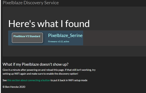

After connecting the USB to power up the PixelBlaze, I navigated to WiFi configuration page supplied by Ben’s setup instructions. The interface was super easy and I had PixelBlaze connected in seconds without having to type any command line gibberish.
