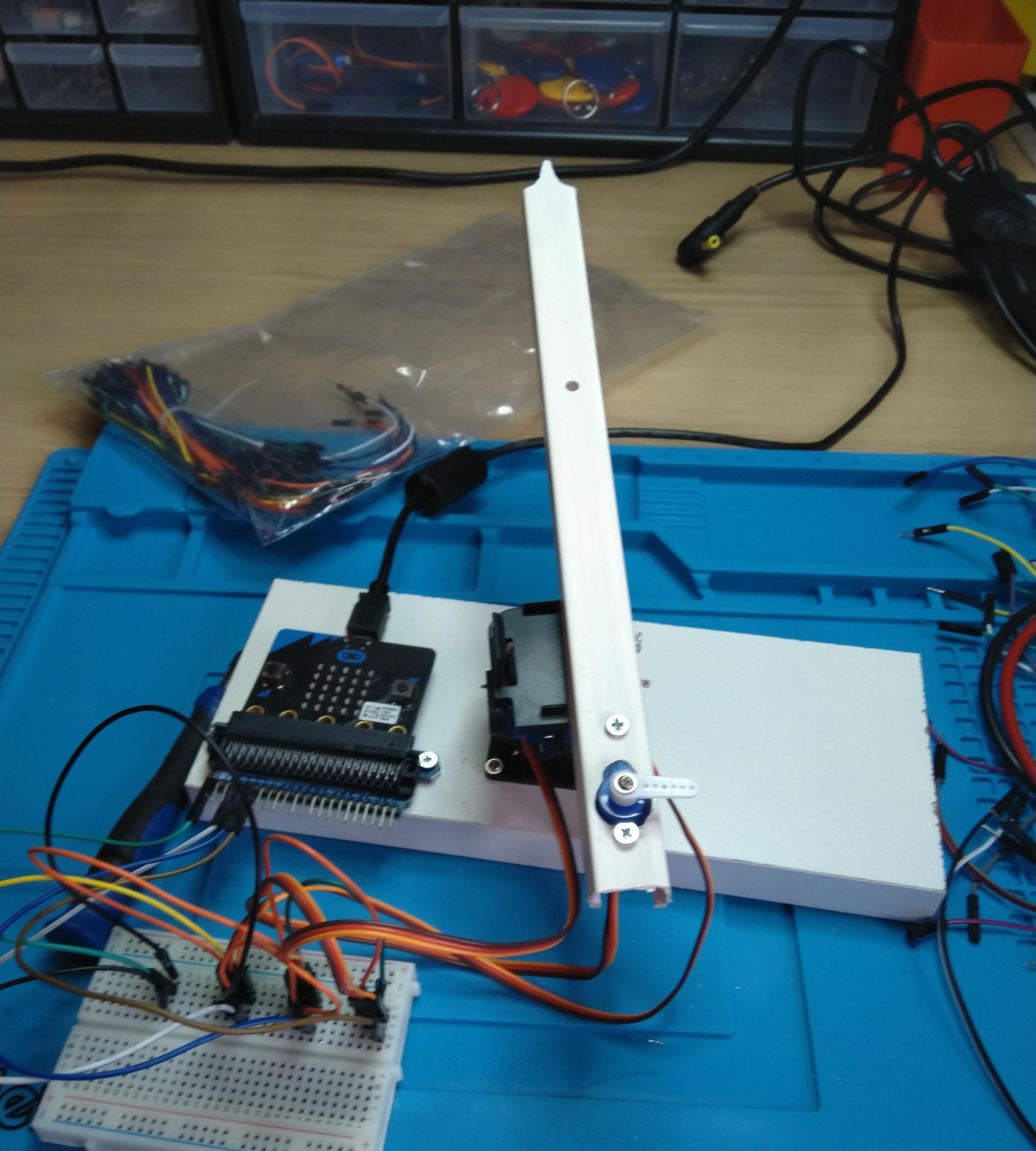

Step 3:
fix the battery holder and the PCA9685 module on the back with a few screws.
in the second image you can see where I inserted the microswitch
