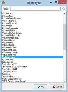

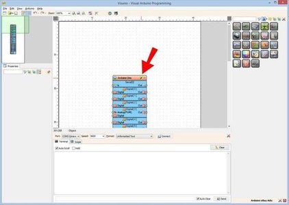

Start Visuino as shown in the first picture Click on the "Tools" button on the Arduino component (Picture 1) in Visuino When the dialog appears, select "Arduino UNO" as shown on Picture 2

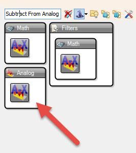

Step 4: In Visuino ADD Components
  • Add "ROHM BH1750 Ambient Light Sensor (I2C)" component
  • Add "Limit Analog between Min and Max" component
  • Add "Map Range Analog" component
  • Add "Subtract From Analog Value" component

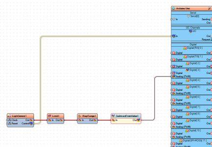

Step 5: In Visuino Set & Connect Components
  • Select "Limit1" and in the properties window set Max to 20
  • Select "MapRange1" and in the properties window set Input Range > Max to 20
  • Select "SubtractFromValue1"and in the properties window set Value to 1
  • Connect "LightSensor1" pin I2C Control to Arduino I2C In
  • Connect "LightSensor1" pin Out to "Limit1" pin In
  • Connect "Limit1" pin Out to "MapRange1" pin In
  • Connect "MapRange1" pin Out to "SubtractFromValue1" pin In
  • Connect "SubtractFromValue1" pin Out to Arduino digital pin 3 >> Analog (PWM)
