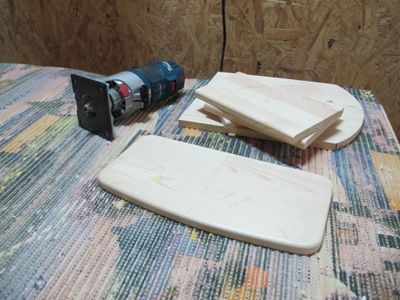

Step 2: Working With Parts
Draw a bow near the upper edge (R168 mm) of the 235x302 board, which is intended for the back. Cut the needed radius using a hand trimmer and a circle cutter. Apply slight sanding.
The upper cap should be made from a 38x80x400 mm work-piece. Mark the center point. Mark off half the length of the upper cap (149 mm) on both sides of the center point. Go 32 mm to both sides and draw a R168 mm bow-shaped top rail. Cut it out using a hand trimmer and a circle cutter. Move the router 25 mm to the side and cut the upper bow down to the arms.
Trim the resulting work-piece down to the specified size. Trim the sides with an electric hand saw. When necessary, chisel the sides. Trim the edge with a trimmer featuring a R5mm rounding cutter.

Mark out the “tray” and cut all radiuses using a hand jig saw.
Chamfer edges using a trimmer with an R5 rounding cutter.
Cut 25x25 mm legs out of a 30x30 mm with a disc saw. Trim them with a miter saw and leave a 6 mm margin. Cut off the back legs’ bottom ends at a 3° angle and parallel the front legs’ ends at the same angle. Make 3 mm chamfers on all legs’ tips.
