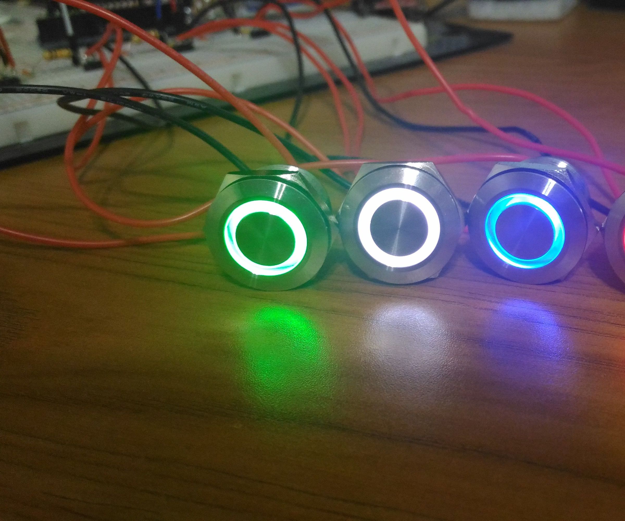

Items you will need:
Arduino Software(including attached sensor of your choice) - We will be using the button project from my previous instructable to aid in this project, but a simple button input, like the StateChange example Arduino provides, will also work.
Processing Software
~We will skip over the Arduino hook-up part, and go straight to the the code and output.
