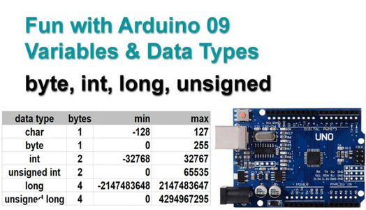

Step 2: Boolean
 It can be set to ‘true or false’, ‘high or low’, and ‘0 or 1’. This data type takes up 1 byte of memory.
Step 3: Byte
We can use this data type if we want to store a value from 0-255. This datatype memory is 1 byte.
Step 4: Char
This data type can only store characters. It is a number, a letter, or a symbol. It is a 1-byte memory.
Step 5: Double
We can use this datatype for decimal numbers. This datatype memory is a 4 byte.
Step 6: Int
This data type is the most used. Its data range is -32 768 to +32 767. This datatype memory is a 2-byte.
Step 7: Long
This data type can be used to store long data. Its range is -2 147 483 648 to +2 147 483 647. The Memory is a 4 byte.
