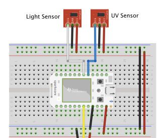

Then, the first thing you have to do is wire up all the sensors so that they can talk to the Spark Core. Each sensor needs connections to +5V, ground, and a digital or analog pin on the Spark Core. Wiring to the same pins shown in the breadboarding diagram (and described below) will prevent you from having to make a lot of edits to the sketch down the road. But feel free to use other pins if necessary.
Light Sensor signal to analog pin A6
UV Sensor signal analog pin A7
Temperature and Humidity Sensor signal to digital pin 6
