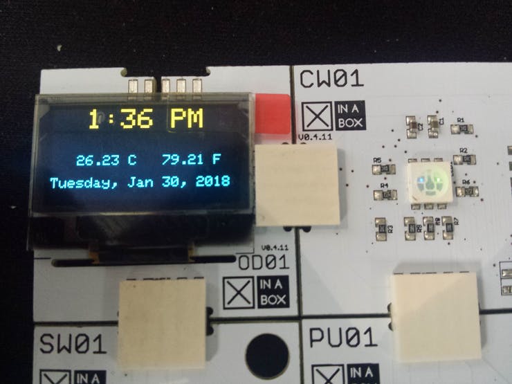

I built this project to display the date, UCT time and temperature using XinaBox xChips that uses the I2C bus protocol. The time was retrieved from a google NTP server. The ambient temperature was measured using the SW01 xChip and was displayed on the OD01 xChip OLED display in Celsius and Fahrenheit. The image below shows the OLED display.
OLED displaying date, time and temperature

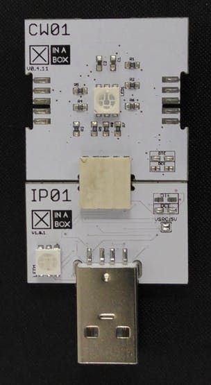

Your main xChip that will execute and process the program is the CW01. It is based on the ESP8266 WiFi Module and uses the I2C bus protocol. In order to program to the CW01, you will need a programming xChip. The IP01 allows us to program the CW01 via the USB port on our computer simply by clicking together the two xChips using XC10 bus connectors and inserting it into the the USB port. No wiring and no soldering required. One thing to take note of is the orientation of the xChip identification names. They should all be orientated in the same direction. You should now have the following setup.
Click together CW01 and IP01 and insert it into the USB port on your computer

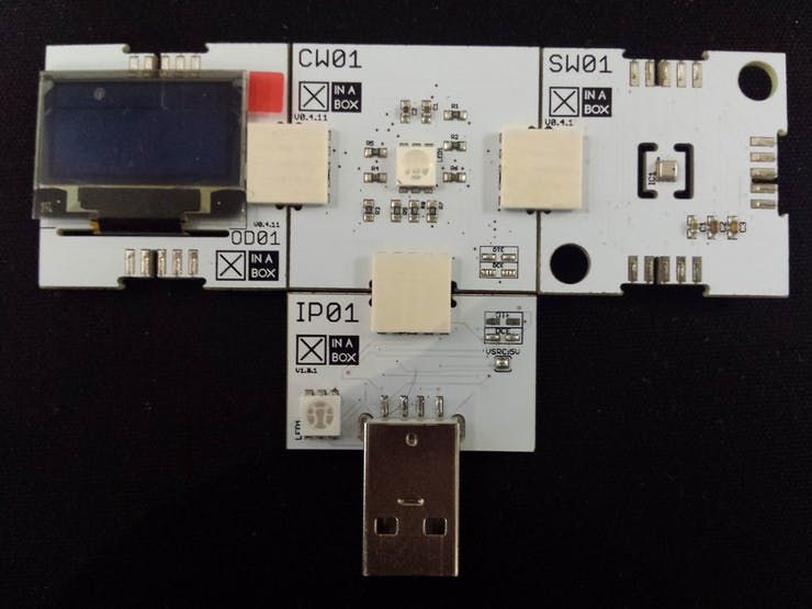

If you are familiar with xChips you may connect every xChip together using XC10 bus connectors that you want to use for your project and then insert it into the USB port. We will be using SW01 temperature sensor and the OD01 OLED display.
You may connect all your chips together and then insert it into your USB port

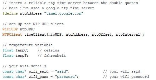

Download or copy and paste the code below into your Arduino IDE. If you aren't making any changes to the code simply enter your WiFi details in their respective fields as shown below. Also enter a reliable NTP time server. I've used a Google time server for this project.
WiFi details and NTP time server

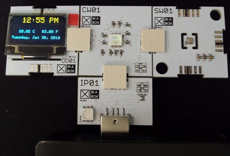

Now compile and upload. Make sure you've selected the correct COM port and board under the tools menu in the Arduino IDE. Once uploaded, the time, date and temperature should show as below.
After uploading you should see the following

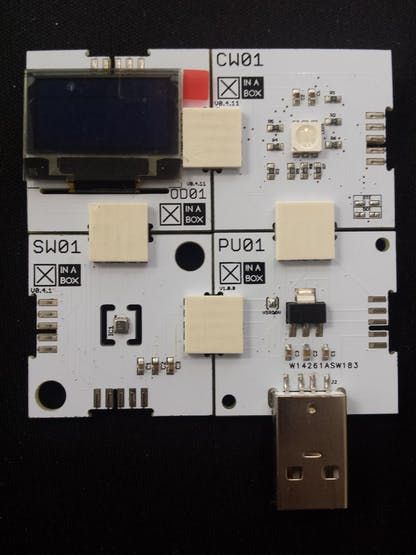

You may now remove the unit from your USB port and separate each xChip by simply pulling it apart. Since the programming is complete, IP01 is no longer required. You may now connect your project in any manner you wish as long as the identification names are all orientated in the same direction. To power our unit we will use the PU01. This allows us to power it from a normal power bank or any 5V USB power supply. I've connected mine as shown below.
Final assembly. xChips can be connected in any way you desire.
