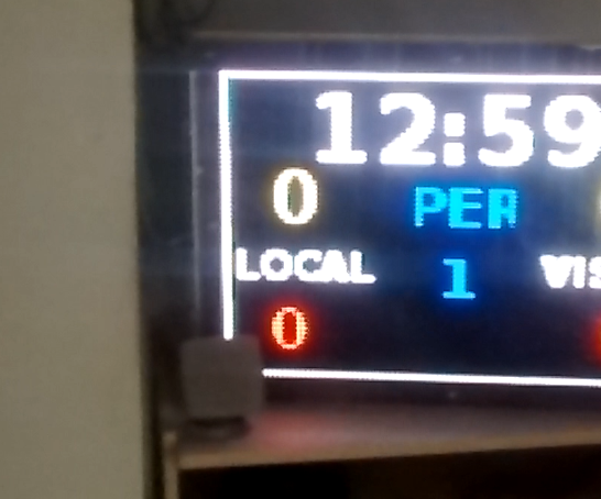

Introduction: DaveWare Led Board
The goal of this project is to build a custom size RGB Led screen based on 32x32 RGB Led panels. This project screen size/resolution is 96x64 (ie, using six -6- 32x32 RGB Led panels). This screen will be used for show information about weightlifting athletes attempts from a C# .NET application which manipulates an Excel file with these athletes information. This application was be programmed using Free Sharpdevelop IDE and .NET Framework 3.5
Step 1: Parts Needed
The parts needed are available from any supplier, but I prefer Sparkfun electronic supplier. The list is as follow:
- Six (6 units:3 columns,2 rows for 96x64 resolution) RGB LED Panel - 32x32
- One Teensy 3.1/3.2 (the computer)
- One WiFi Module ESP8266
- One Power Supply (30A). You can recycle any PC Power Supply. I used one from an old IBM Netvista Desktop
- Screen Frame made of aluminium profiles. This can be obtained locally easily.
- One PCB/stripboard with LED BOARD design
- Other electronics parts detailed in the circuit design: 1117 3.3v regulator, .
Step 2: How to Connect 32x32 RGB Led Panels
This step is the most important. We need to test our six (06) panels with our 5VDC power supply; also test if them works fine together.
For get this first goal, this link was very usable RGB Panel Hookup Guide from Sparkfun
Each RGB LED panel comes with two data cables, and one power cable. One of the data cables will be the INPUT from the computer (teensy 3.1/3.2) as show in figure above. The other data cable will be connected to the NEXT RGB LED panel and go on until reach the sixth panel.

}</bam)-calloverhead);>Step 4: C# .NET Windows Application
This step explains how to the C# .NET Windows Application controls the LED BOARD by commands serially sent by WiFi link established by ESP8266 Module.
- Open the application
- Select option menu
- We need to configure the WiFi connection with the LED BOARD. The ESP8266 when works as an Access Point uses the IP address 192.168.4.1. The PORT in the teensy sketch is 9999.
- Select option/button Conectar for connect Laptop/PC with the LED BOARD.
- Now, we need the list of athletes who are going to participate in competition. You can enter them using the excel template file named campeonato.xls; filling in Excel ALL the records except those referring attempts results.
- Open from the application, the competition file (included within the folder) in excel named campeonato.xls
- Now, you can select any athlete in list in the listview above, and you will see his data into the LED BOARD just using a click.
- For use the application, just click iniciar/pausar button (start/pause, for start or pause the countdown timer); and reiniciar button (restart, for reset count, or finish a PAUSED attempt)
- Finally, according the judges decision, set the lifting attempt valid or avoid. This result will be record in the listview bellow; and save the results into an Excel file with the name you prefer.
