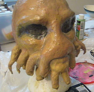

Step 1: Make the Mask
*There are many steps to the mask, so to keep this instructable condensed I have created a separate instructable for the mask--> https://www.instructables.com/id/Davy-Jones-Mask-W...
*Basic steps for the mask:
*Form clay on Styrofoam head in shape of Davy Jones' head and bases of tentacles
*Create tentacles using aluminum foil, cover in clay and add cheerios for the suction cups
*Add 12 layers of liquid latex to the mask head with the last 2 layers being a mixture of latex and paint
*Add 6 layers of liquid latex to the tentacles with the last 2 layers being a mixture of latex and paint
*Add foam/inserts to ensure mask maintains shape
*Cut eye/mouth holes
*Stuff tentacles and attach to mask (Add string + a straw if you want the tentacles to be able to move)

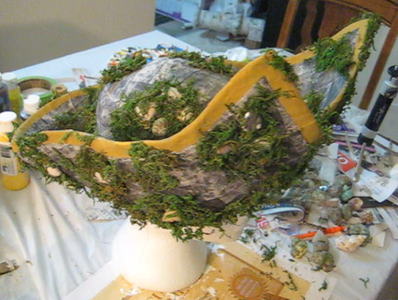

Step 2: Create the Hat
*I have also made a separate instructable for the Davy Jones Hat ---> https://www.instructables.com/id/Davy-Jones-Pirate-Hat/
*Basic steps:
*Get cheap sunhat and form into desired shape using thread, tape, and cardboard.
*Paper maché
*Maché with black material
*Paint boarder with yellow acrylic paint
*Attach moss and shells to hat using a hot glue gun

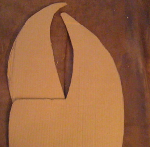

Step 3: Create Moveable Claw
*For lots of details on how-to make this claw click here--->https://www.instructables.com/id/Paper-Mach%C3%A9-Claw/
*Basic steps:
*Draw shapes on cardboard, make sure thumb part is separate. Trace and cut out so you have 2 of each piece.

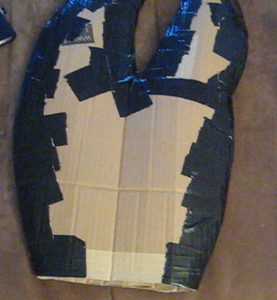

*Tape together

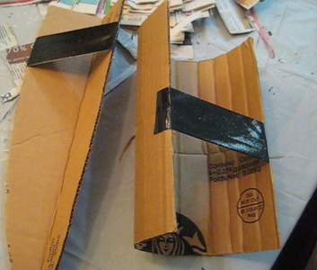

Step 4: Put Together Peg Leg and Pants
*Measure your lower leg from about the knee to the tip of your toe. Draw a long narrow triangular piece for this part of your leg on a piece of cardboard and cut out.
*Measure your thigh from about half way down to just past the knee. Create a piece of cardboard that can wrap around half of your thigh and will extend slightly past the knee.

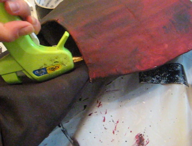

*Flip the pants inside out, and glue the thigh piece so that you can see some of it but part of it is also hidden inside of the pants. To flip right side out pull the pants through the hole, rather than trying to put the thigh piece through the leg as it is too big to fit.
*Cut 2 small pieces of wire and curl the edges so there is more surface at the end and they no longer have a sharp tip.
*Bend the wires so they are curved into a half circle.
*Using a hot glue gun, glue one wire to the top of the shin leg piece. Glue it so that it is horizontal (parallel with the floor).*Loop the second wire through the first one and re-position the shin piece on top of the thigh piece. Glue the second wire vertically along the bottom of the inside of the thigh piece. This will allow you to have some bending movement with the leg.
