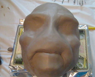

Step 1: Start Sculpting
*Using air dry clay on a styrofoam head, start creating a thin layer of clay
Step 2: Add Basic Features
*Add the basic features and shapes on the mannequin head
*The nose is a lot wider and quite flat overall, and the brows are more prominent

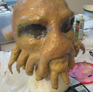

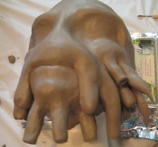

Step 3: Add Tentacle Bases
*Using pieces of clay add the bases of the tentacles
*Also add a few small tentacles that won't extend past the chin

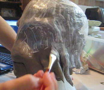

Step 4: Add Liquid Latex
*Using a paint brush add liquid latex
*Let dry between layers
*I painted 10 layers of the colourless liquid latex followed by 2 more layers of coloured liquid latex
*Wash brush immediately in warm/hot water as it tends to stick to the brush quite quickly
*If the latex does get stuck in your paint brush you can remove it by combing it out with a toothpick, though this is tedious.

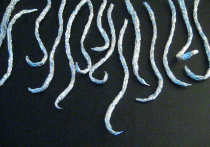

Step 5: Shape Tentacles
*Shape the tentacles from aluminum foil
*I made a total of 18 tentacles
*Bend the foil to give them additional shape with curves at the bottom

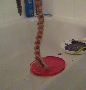

Step 6: Add Clay and Cereal
*Cover each tentacle with air dry clay
*Press in the cereal to create the suction cups
*These do fall off if the clay is not thick enough

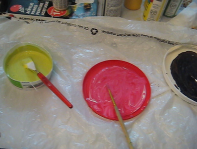

Step 8: Mix the Liquid Latex With Paint
*Using 3 separate dishes, mix paint with the liquid latex in a 50/50 ratio.
*Keeping the colours separate allows you to blend and add colour variety throughout the mask

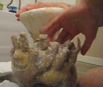

Step 12: Gently Remove Mask
*Gently remove the mask from the foam head by working your fingers along the edges and pulling off the clay
*The clay can then be more easily removed from the mask

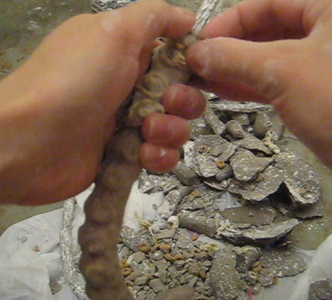

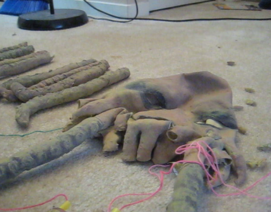

Step 13: Remove Tentacles From Clay
*Make sure the tentacles were covered with corn starch as well
*Working the dry material back about 1cm the cheerios and were able to be pulled off until the whole tentacle was free
*Take your time and be cautious as the latex can easily rip.

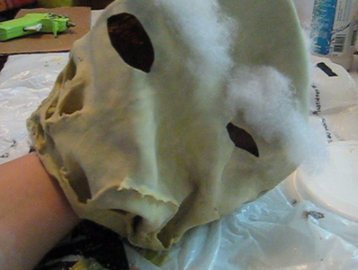

Step 14: Cut Out Eyes and Mouth
*Draw out the size and shape of the eyes that you want and cut out gently
*Cut the mouth flap along the lines keeping it still attached to the rest of the mask. This is very important as otherwise there are no breathing holes in this mask.

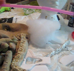

Step 15: Add Some Foam
*Add some stuffing to the eyebrows and nose area to make them more prominent as the mask loses some of the shape after removal from the mannequin head.

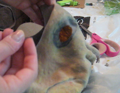

Step 16: Create Nose Piece
*If needed, create a nose piece to make sure the nose maintains the shape that is wanted
*This was cut out from some foam board in the desired shape with a hole for my nose

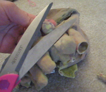

Step 17: Cut Tentacle Bases
*Using sharp scissors cut the tentacle bases so the rest of the tentacles can be placed

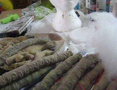

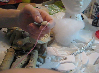

Step 18: Stuff the Tentacles
*Use a chopstick to push some stuffing down to the end of the tentacle
*Use small pieces at a time to ensure the tentacle doesn't rip
Step 19: Glue String to Bottom
*If you want a couple of your tentacles to move glue some string to the bottom of the inside of the tentacle. You may want to glue a small piece of cardboard as well

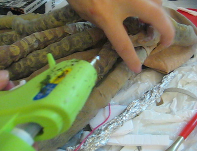

Step 22: Glue Tentacles in Place
*Add some hot glue between the tentacle and the base
*Make sure to do this for all of the tentacles on all sides.
*Afterwards take some of the coloured liquid latex to blend the 2 parts together so there is no visible edge
*Make sure to keep tentacles apart until dry and more corn starch has been applied

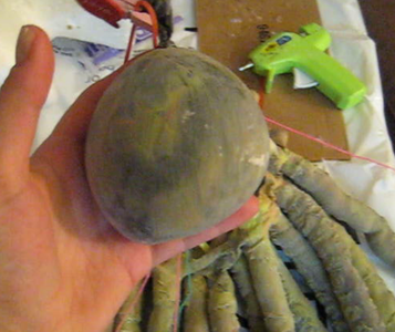

Step 23: Create Back of Head Ball
*Davy Jones has a little blob like part at the back of his head
*Add some stuffing to a balloon, and blow up to the desired size
*Tie the balloon and paint with the latex/paint mixture
*Hang to dry and add corn starch afterwards
