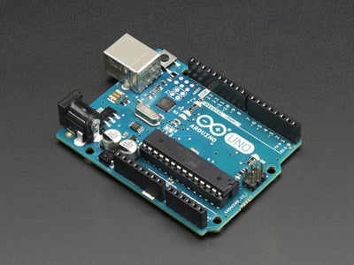

- Arduino Uno or similar

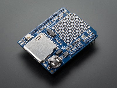

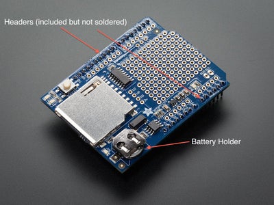

- Adafruit Assembled Data Logging Shield for Arduino (can be found here)

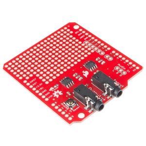

- SparkFun Spectrum Shield (can be found here)

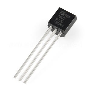

- TMP35 Temperature Sensor

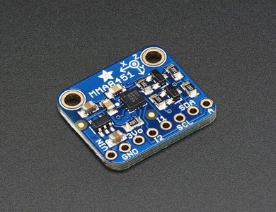

- MMA8451 3-Axis Accelerometer

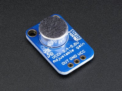

- MAX4466 Microphone

Putting together the shields is very straightforward. Both shields come fully set up and tested with the exception of headers. The data-logging shield comes with a battery for the built in RTC that you will want to install by simply sliding it into place. Then it is just a matter of soldering the stackable headers into one shield and the standard headers into the other, and the shields are fully set up. You will then want to download and install the necessary libraries. The two libraries that you will need for the data-logging shield can be found in the Adafruit tutorial here (this tutorial is also useful if you have trouble setting up the shield or want to test it independently). The spectrum shield does not require any additional libraries, so you should be all set.

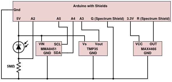

The next step is to build and solder the circuit. The circuit is not especially complicated or extensive; it should be easily possible to fit all of the components in the prototyping areas of the boards. We recommend placing the microphone on the spectrum shield for ease of access, and it is important that the light and temperature sensors end up on the upper board (so that they are able to effectively sense the environment). Otherwise, however, layout choices are up to you.
The photodiode portion of the circuit is a fairly standard circuit for measuring light levels. A simple analog read on pin A2 will serve to find the light level out of 1024. If you find that your values are consistently high or low, experiment with different values for the resistor. We chose our resistor such that in a moderately lit room we read values of around 400.

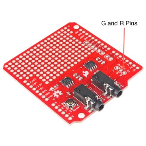

The temperature sensor outputs a voltage that scales linearly with the temperature in celsius (with a shift so that it can be effective below 0°C). The other main circuit elements are similarly simple in how their circuitry works; most of the work is done in the sketch necessary to read the data. For the microphone, soldering the output directly to the R pin on the spectrum shield eliminates the need to use the input jack on the side (and the use of additional adapters).
It is of course possible to change the pins used by the various sensors with some restrictions. The accelerometer uses the I2C protocol, so it must either remain on the A4/A5 pins or the SDA/SCL pins. It is also important to note that the spectrum shield uses the A0 and A1 pins, so it is inadvisable to use those for any of the sensors.

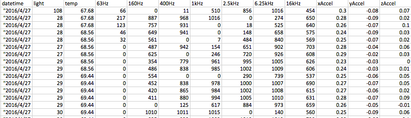

You should now be able to power the Arduino with the 9V battery, pop in the SD card, and use the device. Viewing the data should then be a simple matter of connecting the SD card to a computer and using a program like Excel to view the data as a CSV file. Once you are able to log data in this way, you are ready to work with the visualizer!
