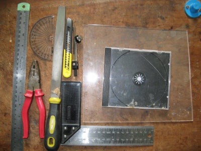

Step 1: Tools & Materials
Tools:
Stanley Knife / Box Cutter
Pair of Compasses
Ruler
Protractor
File
Drill
Pliers or snips
Glue Gun
Lathe or other means of cutting a circle
Materials:
Clear 3mm Perspex
Quartz Clock Movement & Hands
Cardboard
CD Jewel Case
Plantpot tray or similar thin plastic
White Spray Paint
Glossy Photo Paper & Printer
Pair of Compasses
Ruler
Protractor
File
Drill
Pliers or snips
Glue Gun
Materials:
Clear 3mm Perspex
Cardboard
CD Jewel Case
White Spray Paint
