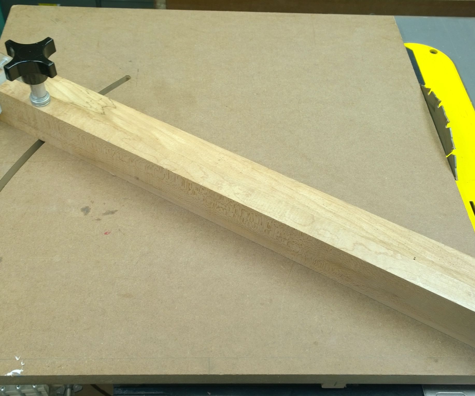

  3. The extension table can be whatever size you want, but for a small shop don't make it too big. The extension table is just a rectangular frame with a cross piece for strength. A piece of 3/4" MDF is screwed to the frame. The height of the frame should be the distance from the brackets to the top of the saw table less the thickness of the MDF table. I would make it a little less to make sure the extension is slightly below the saw table. The width of the frame must align with the brackets it will be screwed to. The depth can be whatever you want. I made mine 17". Screw the top to the frame, counter sinking the screws. Do not put any screws in the area where you will be cutting the miter slots.
  4. When locating the table on the brackets, allow about 2" of clearance for the rear fence clips. At this point you need to clamp the table to the brackets and use the miter in the saw table slots to mark where the slots need to be cut in the extension. Use the saw fence to cut the slots in the extension top. When mounting the extension table to the brackets, use the miter to align the extension slots with the saw slots. Extend the miter far enough to assure the saw and extension slots are parallel. Clamp the table to the brackets and test with the miter or a sled to assure smooth operation. Then screw the extension table to the brackets.
