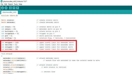

Later on you'll need to fine tune some variables in the code so that your servos have the correct amount of travel to rotate the blade by 90 degrees and extend/retract the fins properly. This is covered in a step during the assembly.

Step 11: Servo Configuration
This is an important step!
Now you have the trigger and push button installed, connect up the two servos (rotator to pin 9, extender to pin 10). Upload the code to the Nano if you haven't already done so. Connect the top plate and main body using the JSTs. Leave the top plate off while testing in case you need to change some variables on the Nano.
If you're using the extending blade, unscrew the pinion, then unscrew the micro servo so you can remove the blade - don't pull it too far off or you might damage the cables. Connect a 2S battery to the XT60 on the top plate. The servos should run through a short routine that would normally put the blade vertical and fins retracted.
Now reattach the blade to the rotator servo. If it won't sit vertically because of the alignment of the teeth on the servo, change the rotupper variable by 5 and reupload the code to the Nano. If it's still not quite right, adjust it by small amounts as necessary and reupload until you get it to sit vertically, then screw it down onto the servo.
Hold the trigger and push the rotator button. The blade should rotate by 90 degrees. If it overshoots, increase the rotlower variable by small amounts and reupload. If it undershoots, decrease the variable. Repeat until you get 90 degrees of movement.
If you're using the extending blade, pull and hold the trigger and then disconnect the battery. Reattach the micro servo, then manually slide the fins to their outermost position and keep them there while you reattach the pinion. Reconnect the battery and wait for the blade to turn vertical and the fins to retract. If the fins are at the lowest point of their travel and the servo is humming as if its struggling then you need to decrease the extupper variable and reupload until the fins stop just shy of the end of their travel.
You probably won't need to change the extlower variable (it's 0 by default) but the option is there.
Congratulations! Your servos are now configured for the proper amount of travel.
