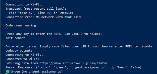

- Configure VSCode:
- Open VSCode and navigate to your Pico (e.g., it may show as drive D:/).
- Press CTRL+SHIFT+P to open the command palette.
- Run the CircuitPython Serial Monitor command.
- Select the correct COM port (e.g., COM10) for your Raspberry Pi Pico.
- Confirm the connection with a notification like “CircuitPython Serial Monitor [Open] Connection to COM10.”
This setup ensures you can run code smoothly while monitoring terminal logs directly from your Pico.

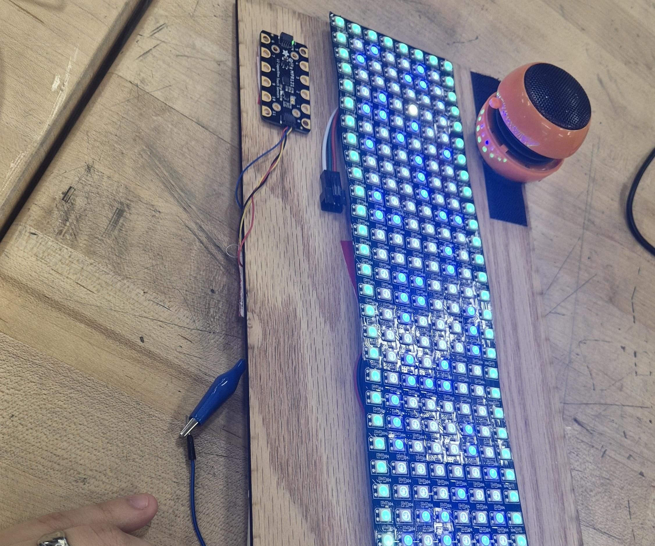

Step 3: Connecting LED Light Strip and Speaker
- Breadboard Assembly:
- Mount your Raspberry Pi Pico on a breadboard to simplify connections and organization.
- LED Light Strip Wiring:
- Power (Red Wire): Connect to the Pico’s 5V output.
- Ground (Black Wire): Connect to a common ground on the breadboard.
- Data (White Wire): Connect to GPIO0 on the Pico.
- Speaker/Buzzer Wiring:
- Speaker Ground: Connect to the Pico’s ground.
- Speaker Signal (Tip): Connect to GPIO14 on the Pico.
- Testing:
- Run a simple test script to verify that the LED strip and speaker are functioning correctly.
This detailed wiring setup ensures that your LED light strip and speaker are connected correctly for optimal performance in your project.

- Included above is some of the Logs for one of the classes I established in COURSES Algorithms
- The logs show specifically the assignments its keeping tracking because the deadline has not passed yet
- In the end of the Picos call to the server it will list with push pins 📌 all assignments yet to be completed and whether it should mark them as Urgent to complete based on the due date and current date
Step 5: Setting Up Our Pico to Call Our Server and LED Lights +Speaker
Connect to Wi‑Fi:
- In your Pico’s code.py, configure the Wi‑Fi credentials so the board can connect to the internet.
- I put my wifi credentials in config.py and just imported them into code.py
Fetch Server Data:
- Use the adafruit_requests library to call your server’s /status endpoint (e.g., your-app-name.fly.dev/status).
- Process the returned JSON data to determine the current state (green, yellow, red).
Update Visual Output:
- Use the LED light strip to display the corresponding color:
- Green: No urgent assignments.
- Yellow: Tasks due within 24 hours.
- Red: Urgent assignments due within 4 hours.
- Implement an LED animation (e.g., a comet effect) that runs continuously until new data is fetched.

- I would add a screenshot of what the terminal output on your circuit python serial monitor will look like

red_comet = Comet(pixel, speed=0.02, color=RED, tail_length=int(NUM_PIXELS * 0.25))
# Connect to Wi-Fi
print("Connecting to Wi-Fi...")
wifi.radio.connect(config.WIFI_SSID, config.WIFI_PASSWORD)
print("Connected to Wi-Fi!")
# Setup requests session
pool = socketpool.SocketPool(wifi.radio)
session = requests.Session(pool, ssl.create_default_context())
def fetch_status():
Fetch the status from the Flask server and return the JSON data.
try:
print(f"Fetching data from {SERVER_URL}...")
response = session.get(SERVER_URL)
if response.status_code == 200:
data = response.json()
print("Server Response:", data)
return data
else:
print("Failed to fetch data, status code:", response.status_code)
return None
except Exception as e:
print("Error fetching server data:", e)
return None
def update_status(data):
Process the server response and return the appropriate comet animation.
course_statuses = data.get("course_statuses", {})
final_state = "green"
yellow_cause = []
red_cause = []
for course, details in course_statuses.items():
course_color = details.get("color", "green")
if course_color == "red":
final_state = "red"
red_cause.extend(details.get("urgent_assignments", []))
break # Prioritize red
elif course_color == "yellow" and final_state != "red":
final_state = "yellow"
yellow_cause.extend(details.get("yellow_assignments", []))
# Choose the appropriate animation based on the final status
if final_state == "red":
print("🔴 Red (Urgent Assignments within 4 hours!)")
for ra in red_cause:
print(f" - {ra['name']} | Due: {ra['due_at']}")
return red_comet
elif final_state == "yellow":
print("🟡 Yellow (Assignments due within 24 hours)")
for ya in yellow_cause:
print(f" - {ya['name']} | Due: {ya['due_at']}")
return yellow_comet
else:
print("🟢 Green (No urgent assignments)")
return green_comet
# Main loop: fetch data, then animate until next fetch
FETCH_INTERVAL = 300 # seconds
while True:
my_audio.play_audio("chime.wav")
data = fetch_status()
if data is None:
current_anim = green_comet
else:
current_anim = update_status(data)
start_time = time.monotonic()
while time.monotonic() - start_time < FETCH_INTERVAL:
current_anim.animate()
time.sleep(0.01)

Step 6: Make a Box to Input Your Pico Wrap LED Lights Around for the Comet Animation
- I laser cut a foldable box to store my wiring
- I placed the hamburger speaker on top of the box so the chimes would be clearly heard and then proceeded to glue it shut
- The audios path was audio/chime.wav in my D:/ workspace
- the current my_audio.py works with wav files but could be modified to mp3 if desired
