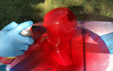

Afterwards I glued the pieces together. I noticed, that using acetone and rubbing the head down with a towel saved me quite a lot of sanding later on. I highly suggest to spend some time on sanding and priming (use a "Filler Primer"), since it will improve the smoothness of your final product quite a lot.
Now all that is left to do is to paint the head. Congratulations, you are done.

After about a two weeks I realized that some imperfection were starting to show up. I didn’t pay much attention to them until after a month cracks started to form where I had glued the parts together. After spending hours priming and sanding I couldn’t believe my eyes.
I used "Universal Primer Filler" from Spraila which seems to have different material properties than the PLA and so due to the temperature changes in my kitchen it started to shrink.
Since I had recently bought XTC-3D I decided to give it a try. It’s a resin specially developed for coating 3D prints. I used a thin layer, which didn’t cover the cracks, so I decided to use a thicker layer. This was a very stupid decision, due to the low viscosity drips started to form and I had to spend a very long time sanding the head to get rid of them. As you can see in the second picture I accidentally sanded through the XTC-3D in some places. So I filled the cracks with Autobody filler, used a thin layer of red primer (Dragon Red by Army painter) and went with two thin layers of XTC-3D. After carefully sanding the head I primed it again and painted it.
So far it still looks perfect, I will keep you posted.

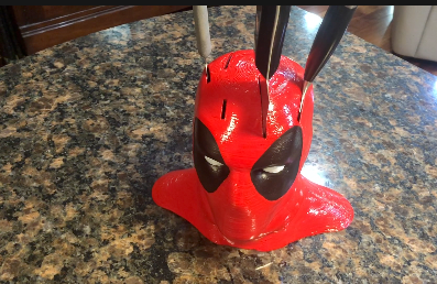

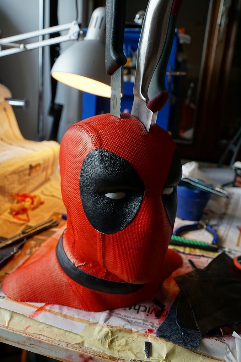

Printed in one piece, scaled to fit on the Prusa i3 MK2 fully. 3D printed in black PLA, Spray painted red, and then acrylic for the mask details. I changed the nozzle to 0.60mm and the layer height to 300 microns. 10% Honeycomb infill. Cut time down to just under 20 hours for printing.
I made this for my brother for his new kitchen and he LOVES IT! This instructable was very helpful - great job! I made a timelapse of making it, you can find it here if you're interested:

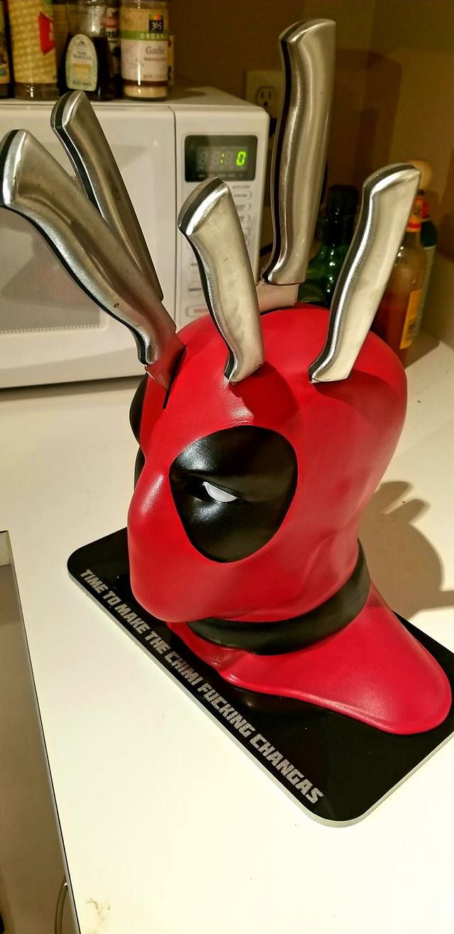

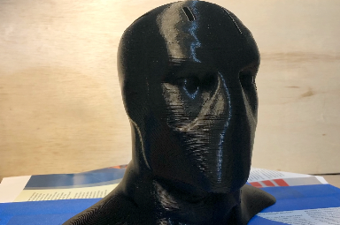

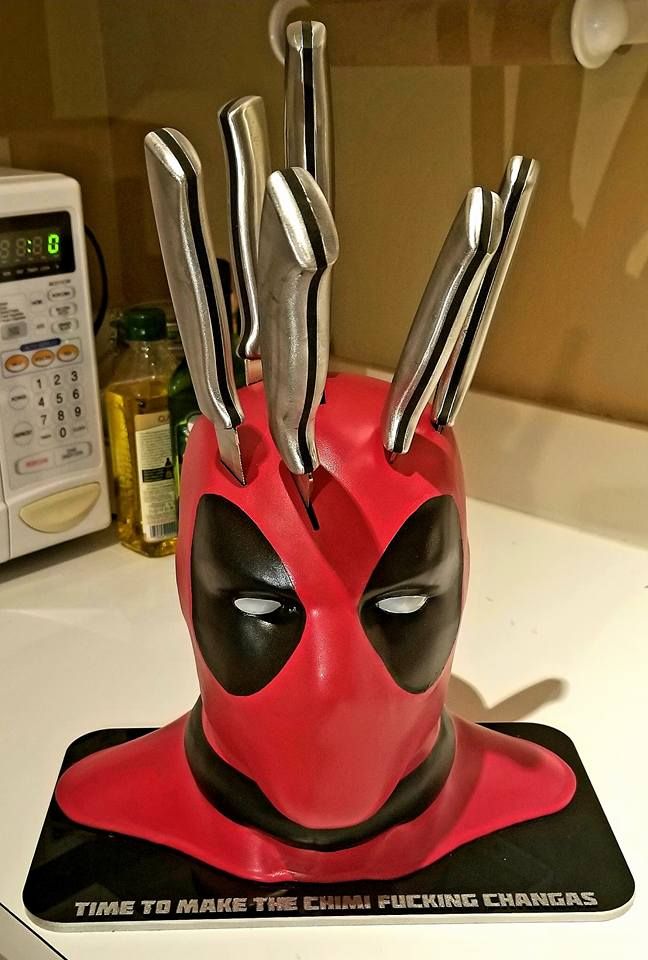

Printed this using the individual parts instead of doing it all at the same time, and ran into a pretty serious issue. The solid top section + the two hollow lower sections cause it to be very top heavy. So, I made a base for it after all was said and done. Great instructable and an awesome idea in general.
Raymond Potter assembled the body and was the painter on this model.

Reply 3 years ago
Great job, thanks for posting a picture. The base looks great, really smart problem solving
