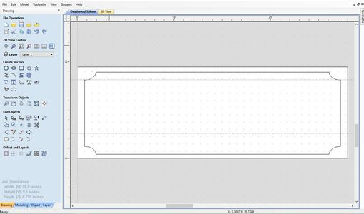

Step 1: Design Sign and Preview
I used Vectric Aspire to design my Saloon sign. I started out with the cutout portion, made a rectangle with internal radius corners. I then design the center and corner designs. Inserted Deadwood Saloon text, using Hoedown font.
