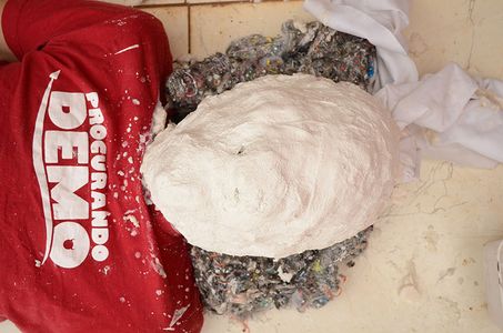

Step 2: Preparation
Lay your friend on a comfortable place that can be soiled - the floor or a large table. Wrap his or her head with plastic film, protecting the hair; it will get the aspect of a bald person. Moisture his or her eyebrowns and eyeleashes. Tie the fabric around his or her head. It will define the depth of the mask, because it's the fabric that will stop the alginate from draining. Try to keep the fabric as low as possible, just like the picture.

Step 4: Placing Plaster Bandage
Now your friend must remain with his face covered for a while. Some people may find this experience a little bit scary and uncomfortable, so he or she may try to keep calm and breath deeply, and try not fall into despair. Some people relax easier with a song playing, or if someone keeps talking to them, just so they know there's someone there.
You will now start to put the plaster bandage over the alginate, so it won't break when took off. Cut some strips with the scissor, then dip it into the water, place over the face of your friend, and slide your fingers to release the plaster. You may cut smaller strips for the nose area, remebering always to keep holes for your friend to breathe. Make two layers and wait for it to drain - the draining time depends on the climate.
