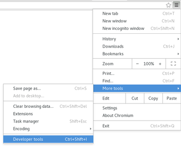

    Step 2: Start the Chrome Developer Tools
      Next, open the developer tools in Chrome. To do this, open the Hamburger Menu, open the more tools submenu and click Developer Tools. This should open a panel in Chrome. It contains a number of useful tools for developers. In this Instructable, I will have the panel attached to the bottom of the screen. To attach it to the bottom yourself, click the three-dotted menu by the close button and choose the horizontal rectangles.
