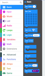

Set up a Microsoft Micro:bit account, and begin a new project. If you aren't familiar with block style code, it may be best to start with one of the tutorials offered first. If you have already done one or two, then this is not too far of a stretch.

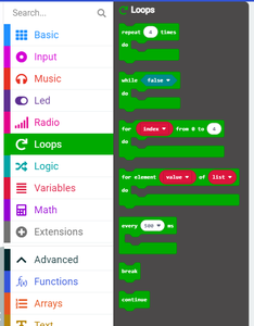

It's important to familiarize yourself with the various tabs you'll need to get your code blocks from. The initial menu has most of what you need (pic 1), but there is an additional tab in the advanced section (pic 2) that we need as well. You can simply click on the block you need and that will place the block in the coding area. You can always simply duplicate what you need, or you can go back and grab blocks as you need them.
Let's list out the [code blocks] you need from each section, along with the total amount:
Basic (pic 3)
  1. [Forever] -1
  2. [Pause] - 5
  3. [Show LEDs] - 6
  4. [Show number] - 6
  5. Optional-one additional

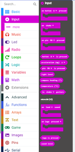

Input (pic 4)
  1. [Sound level] -11
  2. Optional - one additional
  3. Optional - [on button "b"]
Loops (pic 5)
  1. [Repeat 4 times, do] - 4

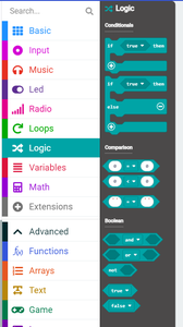

Logic (pic 6)
Conditional
  1. [If true then, else] - 1
Comparison
  1. [0 < 0] (any comparison block would do really) - 5

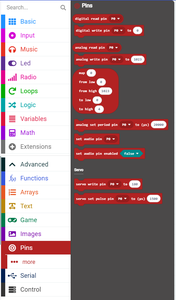

Pins (pic 7)
  1. [Digital write pin P0 to 0] - 12

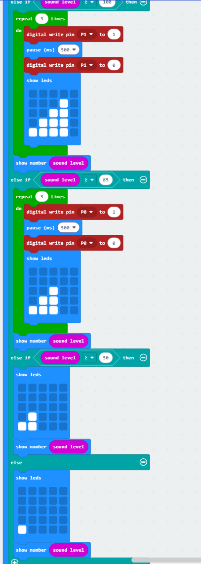

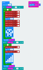

Take a look at the program in the first two images. This is the complete program. While I won't go step by step with what to do, since it's highly visual, I will discuss the order and why things are where they are. I have also included my original plan, to see where I made changes, as well as the hex file itself.
The program starts on a [forever] command, meaning the program will run continuously while there is power. Everything needs to go inside of this.
The [If-Else] block nestled inside is really about the order you want your cause and effect to show up. Since the theoretical default is a very quite area, then the lowest decibel read is at the bottom of the order. The program should continue to move down a list until it hits the right conditions, hence the if-else. "If it's not this loud, then let me check if it's this loud".
I chose the decibel levels based on thresholds of hearing from this site.
The [pin] blocks are about sending signals/ currents to the assigned parts on the Micro:bit. They have to be in pairs of off (0) and on (1). I chose to do this stop light style, since we're used to it. Of course, if the decibel level is too high then it's best to get attention anyway you can, with all of the lights in this case.
The [show LED/ show number] blocks are redundant, and if you want to take either out, you can. Originally, the LED designs were connected to sound, but with a Micro:bit sound takes up the 0 pin slot. I took out the sound, but the visual scale remains. This is also why the [On button B press] exists, to check the meter to see sound thresholds.
The [pause] blocks are necessary to create buffers in some of the actions, such as ligthing the LEDs long enough to be visible.
The [repeat] block was paired down to three for timing purposes. I felt three visible flashes was enough.
