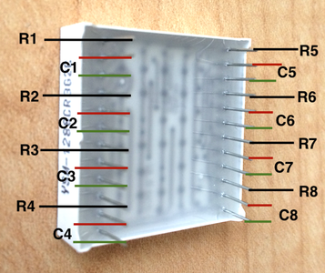

Step 3: External Display: Understanding the LED Matrix
The LED matrix we used has both red and green LED's, but we just used the red LED's.The datasheet for the LED matrix can be found here. The datasheet did not include a schematic for which pin was a row or column. Use the images above to determine the rows from the columns.
Step 4: External Display: Pinning and Wiring the Breadboard
Now that you understand the LED matrix, put it on the breadboard. Use wires to pin every row and every red LED column. You will need a resistor for every column or LED in the matrix. From the LED matrix datasheet, we calculated that you would need 47 ohm resistors. Put these resistors on the breadboard and wire them to the columns of the LED matrix. Use the diagram above as a reference. The blue wires represent the rows and the red wires represent the columns. Once you are done with this step, you should have 16 wires each with its other end not connected to anything. These wires will connect to the Pmod connectors described in the next step.

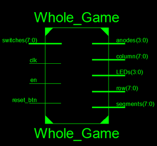

Step 6: Understanding the High Level Black Box Diagram
The diagram above is the high level black box diagram for the game. Here is a list of inputs and outputs with descriptions of what they are.
Inputs:
- switches: Each of the eight switches are used by the player to input their answer.
- en: The en is a button and when pushed, it will give a new random number.
- clk: The clock signal from the Nexys 2 board, which has a frequency of 50MHz.
- reset_btn: When pressed in conjunction with the enable button, then random number value will reset.
Outputs:
- anodes: These control how many 7 segment displays are in use.
- segments: These display binary numbers in decimal form.
- row: The row output represents the rows of the LED matrix.
- column: The column output represents the columns of the LED matrix.
LEDs: These are the LED's on the Nexys 2 board.

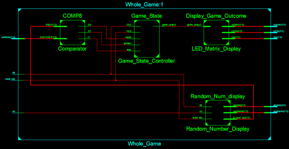

Step 7: Understanding Game Block Diagram

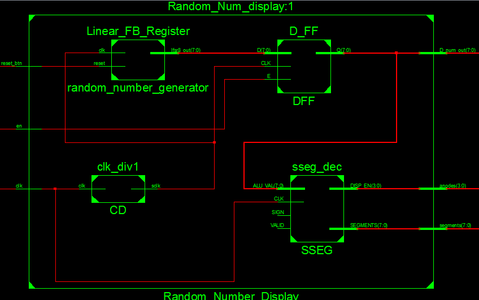

The first diagram shows all the inputs and outputs in which the game is tied together in one module. The second diagram shows the modules within the Random_Num_Display.
Step 8: VHDL Modules Descriptions
Linear_FB_Register (Random Number Generator) Module
This module is what generates a random number. At the rising edge of clock, the output 8 bit number will be “00001111” or 15 in decimal if the reset is ‘1’. The rest of the time a random number will be generated continuously.
D_FF (D flip-flop) Module
This module is a D flip-flop. Its input gets the output of the random number generator. At the rising edge of clock, if the enable (button) is ‘1’ then the input is latched and therefore the output of the flip-flop.
sseg_dec (Seven-segment Display Decoder) Module
This module was written by Bryan Mealy of California Polytechnic State University on December 16, 2010. It is a four digit seven-segment display driver. It takes in the 8 bit number output from the D flip-flop and converts it to a decimal number. The decimal number is then displayed on the seven-segment display on the Nexys2 board.
clk_div1 (Clock Divider) Module
This module was written by Bryan Mealy of California Polytechnic State University on December 27, 2010. It takes in the clock frequency and divides it into a slower frequency. This slower frequency is used as the clock for the random number generator and the D flip-flop.

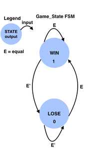

Game_State Module
This module is a finite state machine, see diagram above. Its two states are win and lose. If the output from the Comparator is equal and not less than and greater than, then the game is in state win. If the output is less than or greater than and not equal, then the game is in state lose.
LED_Matrix_Display (Game Outcome) Module
This module displays whether the player’s answer is correct or incorrect. If the game state is win then the player is correct and the 8 green LEDs on the Nexys2 board will be on. If the state is lose then the play is incorrect and the red LEDs of the external LED matrix will be on.

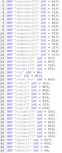

Step 10: Pinning the Inputs and Outputs
The image above states where on the Nexys2 board each input and output is mapped to. Please note that the LEDs output is only pinned to four LED's. This is because Pmod D, the Pmod used for the rows in the LED matrix, has pin assignments which are shared with LD0, LD1, LD2, and LD3. For more information, refer to page 15 of the Digilent Nexys2 Board Reference Manual here.
