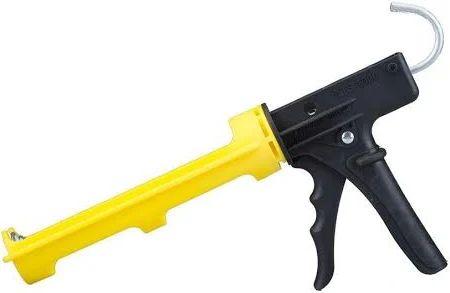

(7.0) Caulk gun.
Note, you don't have to measure where you put all your kerfs (the distance between them). Mark a couple and just try to stay with that pattern.

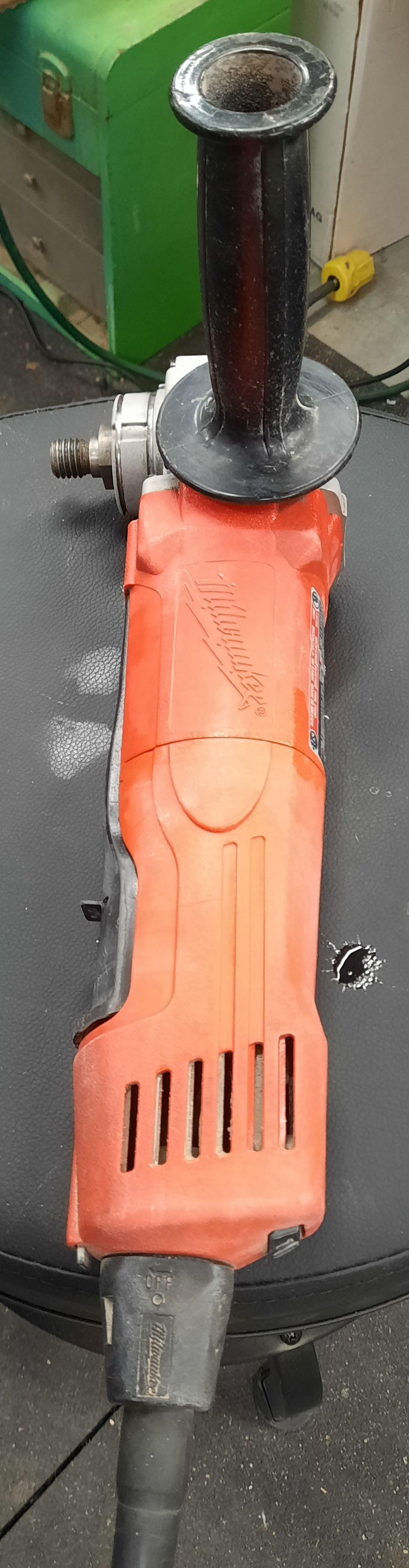

(11.4) A common angle grinder, for the grind stone and polishing pads.
AGAIN, FOR SAFETY, POWER YOUR GRINDER FROM A GFI, BECAUSE YOU'LL BE USING ELECTRICAL EQUIPMENT AROUND WATER.
NOTE: Also, consider a more expensive variable speed grinder. Though they do cost significantly more, it would be a lifetime investment for all but a few, and the variable speed will allow you to do things with the grinder a standard, 10,000 RPM, grinder would be far too fast to do.

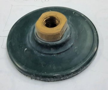

(11.6) A threaded four inch (4") hook-and-loop pad for your angle grinder.

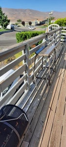

Step 2: Stabilizing the Deck Railing
(1.0) I focused on the problem of stabilizing the long railing run movement before tackling the failing railing cap issue.
(2.0) To make the railing more ridged, I considered adding 4x4's that would extend about seven feet above the deck and tying them back to the roof by way of a slightly tilted 2x6's mounted on edge, but then thought about my days of riding the Washington ferry system.
(2.1) If you look at photos of the rails on the observation decks of ferries, you'll see railing with pipes approximately 1-1/2" in diameter running back from the railing tops to the decking at about a 70-degree angle. And they are installed every few feet, to make the already well-built railing even more stable.
(3.0) I had 3/4" conduit a friend gave me from when his workplace performed a major renovation and was hauling all the old stuff to the landfill. I cut the conduit into forty-two inch lengths, then hammered about 4" of both ends flat, to allow me to secure the flattened ends to a vertical rail post and to the edge of decking.
(4.0) Once the ends were flat, I bent them at the job site, to get the right angles for attachment. The angles changed, because of the pattern of the decking was different on the different sides of the deck, but adjusting the angles was one of the easiest things about the project.
(5.0) Drilling the holes the bottom deck screws would go through, when running the screw into the 1" or 1-1/2" decking (done at a slight angle) was best done at the time the braces were installed. This is because the brace positions changed, depending on the decking patterns and material.
(6.0) I installed three braces on the long rail run. Had the run made a ninety on the west end, like it did on the east end, I could have stabilized the railing with two, but, because the west end terminated at a gate leading to a one-story stair, rather than a ninety-degree turn, I had to add a brace there too. The West side got two braces, and the east side got one.
(7.0) After the braces were installed, the improvement was immediate and obvious. The railing went from moving as much as four inches at the center of the long run to, at most, moving about 1/8" to 1/4" (see photos of the angled braces).

(2.8) Once all the slots were cut, it was just a matter of laying composite boards I'd cut to length, allowing about 1/8" gap on each end, where the boards butted up to a piece of granite, on the railing cap supports, clamping it in place, then installing the Z clips.
SIDE NOTE: I buy screws in bulk. In part because I have the room to store them, and because I've found I can get hundreds more for just a few dollars more. Too, I try to stay with square drive heads, because they are far less likely to strip, and will, usually, stay on the end of the driver bit to get them started.
(2.9) To install the Z clips, I tried #6 square drive screws that are 5/8" long. That length left zero danger of piercing the tops of the composite boards. That aside, I dropped a lot of the #6 screws, and suffered a lot of finger pinches, trying to get them started. I switched to #8 square drive screws 5/8" long and the installation of the clips became a breeze.
(3.0) Once all the cap and rail was in place, I used blue painters tape on the composite and granite, where they met, to allow me to caulk all the joints without creating a horrible mess.
SIDE NOTE: As mentioned, it pays to use a good quality, elastomeric caulk, for its durability and flexibility. Even then, a week or a month in, you'll have to come back and touch these areas up again.
(3.1) I, also, caulked all the kerfs/slots the Z clips mounted into, and everywhere the composite cap laid on the support under it. This both increased the soundness of the attachment between the cap and support, it made for a much better looking end result.
