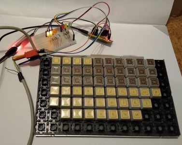

To put it together this far and get the software running was not much of a challenge, because that are things I am used to do. All that was left to do was to pluck in a USB power bank and to put everything in a nice enclosure. And that's the state the project had, when it went inside a cardboard box for a long time. For me the enclosure was more of a task, than the electronics. But at last I finished it an I am pleased with the result.

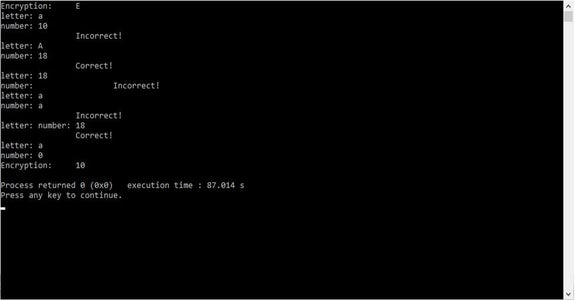

This projects first software is even older than the stuck together hardware. When I came up with the idea to build a new version of the game with different encryptions my siblings and I took out the scrabble game and made a lottery to get 15 new encryptions like I discipled in the instructable about the original quiz. I decided early on to use a 4-bit-4-button-4-LED hexadecimal code to select the encryptions and for code 0x00 the old encryption had to work obviously. The game had to be downward compatible so we can still use all those old quiz sheets.
As soon, as we had the tables of the encryptions, for convenience one in numerical and one in alphabetical order, we began to design quiz sheets. And to check those quiz sheets I made a little console application. I think no one besides myself ever used it. But it gave me pretty much everything I needed for my uC-SW-project minus the communication to the keyboard I describe in detail in my instructable featuring PS/2 keyboards.

The cash register keyboard works a little different than the silicone one I used perviously:
  • It has 2-key rollover so it will ignore all pressed keys, after the second is pressed. If that doesn't work for you, you would need to scan the matrix on your own. You can get multiple-key rollover that way but more GPIOs are required. I have still 8 byte buffers for numbers and letters in my code. Those are really overdimensioned now.
  • When a third key is pressed and one of the previous keys is released, the third key pressed will be output at that time.
  • Make codes are not repeated. Since I ignore repeats, that is no problem, even welcomed. But I already put in some code to ignore repeats and left it, even if it's needles now and makes the code a little more complicated to read.
Some testing showed, that if I hit the keys wildly, some unwanted events occurred:
  • The PS/2 interface reset, because there was no idle state detected for 250 ms (a safety precaution built in by me). I made sure that the communication counter can be reset during every main loop run, when the communication is in idle state, while the counter is only increased, when a systick occured (once per ms). No unwanted resets occurred since then.
  • The selected encryption was reset to zero with the PS/2 interface while the LEDs still showed the encryption selected before. I made sure, that the encryption is only initialized during boot up.
  • Break codes can be missed in rare cases (when checking through all possible combinations fast). So the older entry in a buffer (letters or numbers) is deleted now, when both buffers together have more than two entries. That just can't happen in error free operation, since the keyboard has 2-key rollover.
Instead of using the stdio library like the console application does, I read in the inputs via the PS/2 interface directly and output some signals using LEDs. Green LED instead of printing out "Correct!" Not much of a difference in the code. And the best thing is, I was able to just copy the 16x26 array with the correct combinations. Both codes are written in C.
I check if there is exactly one number and one letter in the buffers, if that holds true I check if the combination is true and set the according LED-output to high and the other LED-outputs to low. The number and letter to check are now element 0 of my buffer. In C arrays start with the element 0, so one more index can be used compared to starting with 1.
In my notation the letter associated to 1 is in the first entry (entry 0), the letter associated to 2 in the second (entry 1) and so on. So that's were the [number-1] comes from.

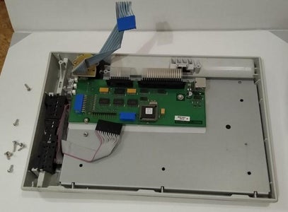

Step 3: Disassembling and Modifieing the Keyboard

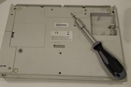

The used keyboards looked very used and the basic cleaning the seller mentioned in the desctiption was no cleaning at all. Or holding the keyboard upper side down, hoping that some dirt might fall out from it. But I wanted to disassemble them anyway. To do so, I needed a T 8 bit. The first one I opened quite some time ago and I didn't have the huge bit set jet. So I used some small slotted screwdriver. It wasn't a high quality one and you could see some wear around the edges afterwards, but it worked.
The keyboard also includes a key operated switch magnetic card reader. I don't need them for this project so I just plugged them out and put them away for now. The keys come off easily and with a small slotted screwdriver I was able to remove the transparent covers from the backside. I threw the paper inlay away, as I will make my own later.

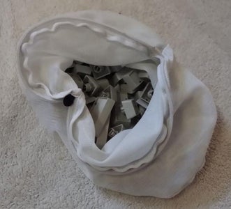

Then I put all the small plastic parts in a bag to wash them at low temperature of 30 °C and without spinning in the washing machine. I read this for Lego and yes, it works with keys as well. It might have been wise to wash the transparent covers and the keys in different bag, because many reassembled them self and I had to disassemble them once again.
Most of the keyboards I didn't disassemble further. I cleaned them a little with the vacuum cleaner and if I felt like it, I brushed them and vacuum cleaned again. The black plastic protects the rubber domes quite well so it is okay to brush over it. But one of the keyboards I disassembled, was dead dirty. I disassembled it further to clean between the layers. I included the photos, as you can see the structure of the matrix. To unscrew the PCB I needed a T 10 bit.

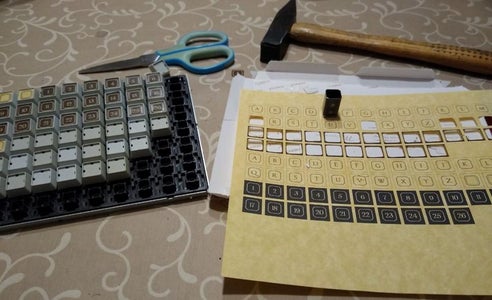

To modify the keyboard I placed small keys with transparent covers where I need them, made and printed some nice paper inlays - for this one I used a typeset I saw in the instructable of Miss Betsy's Steampunk Keyboard - an cut them out. For my prototype I used a guillotine cutter, now I have a cheap set of different formed hole punches. One of those fits - hmm... not really perfect, it isn't even really spare. I have to trim with the scissors, but it is okay. With the guillotine cutter I tended to make them a little too small, so I didn't have to cut corners afterwards. That's less alluring with the punch so I get inlays, that cover more of the space and I'm quite happy with the result. The key design with the frames is a little tricky. If you don't get it centred well or it is a little inclined, it's easy to notice.

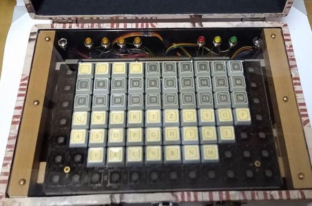

First I got the three wooden bars and the one aluminium bar ready. It is a good Idea to think early about the placement of your holes. After assembling the bars some points are difficult to reach with the drill and I don't want to hit a screw with another. So I drilled most of the holes in advance. Of cause I forgot one or two, but that was okay.
I had a sheet of paper cut to the inner dimensions of the suitcase, so I could align the bars and then screw them together. I mounted the wooden bars first and screwed the keyboard centred to the aluminium bar. I used some 5 mm spacers + M3 washers to bring the keyboard as close as possible to the level of the front panel. I glued them in place with superglue, because otherwise it's a pain to get those small parts in place all the time. If you don't have thread cutters you can use super glue to stick nuts to the backside of the aluminium bar and work with simple holes. I did so when I assembled the prototype. The nut might come off, when you tighten the screw, but that is okay, since the nut is already in place. But if you have to dismount the keyboard again and the nuts falls down, it's annoying.
I brought the frame to a plane level inside the box using some pieces of wood. I could still shift the keyboard around a little, since the aluminium bar was not connected to the wooden elements yet. The width of the aluminium bar is a few millimetre less than the inner width of the suitcase to have some tolerance. I put the front panel on top and tried to centre everything. Then I put the front panel off again an screwed the keyboard to the wooden bar. Then I flipped the framework to fix the aluminium bars to the rest of the construction.
Then I fixed the MDF sheet to the bottom side, to make sure that nothing deforms, when I dismount the keyboard, and mounted the power bank and PCB mount. Then I got the electronics ready. My main source of wires was an pre-configured cable harness of four wired flat band cables. I'm not sure where I got it. To connect the keyboard I cut the PS/2 cable, that came along, to a fitting length and soldered it directly to the uC board. To connect the power bank I used a micro USB socket breakout board to connect the output and cut a micro USB cable for the charging input. I used the rest of the cable later on to make a cable for charging, that can be used with a common USB charger.
I mounted the uC board, connected the power bank and begun to screw the frame to the suitcase. Screw clamps were essential to fix the frame at the right hight and to hold it tight to the side panels while the screws cut in.
Next I added the LEDs, the switch and the charging socket to the front panel. Since I had to remove the protective film I had a cloth ready, so I could put the panel down at a place, where it won't scratch. Then I connected the series resistors and the wiring of the panel elements. I used the connectors of the wire harness so I can remove the front panel with all elements, when I disassemble the box.
Before I fixed the keyboard, it would have been a perfect time to vacuum clean the inside of the box. I had to dismount the keyboard once again. But I fixed all wires at least. And yeah, I put some yellow LEDs under the keyboard, but I have to exchange them for brighter ones because you don't see much of them.
Update: I exchanged the LEDs by now and included a image of the illuminated quiz.
It is good idea to check the functions and clean the inner side of the front panel with some microfibre cloth before you fix the front panel. I centred it once again to get a regular gap around the key field, pre drilled the wood an put in some screws with a shiny head. I like the mix of the vintage suitcase, the see through electronics and the pattern of the unequipped parts of the keyboard. In my opinion it looks quite nice.

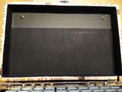

Step 6: The Prototype
Just because it featured adequately bright LEDs underneath the keyboard and the option to put quiz sheets in the lid with magnets first. Sadly DIN A4 paper doesn't fit in. But That was not enough of a reason to go for more bulky boxes.
Update: For the ferromagnetic strip to pin sheets I used a self adhesive steel ruler. It was a rest that was left after I used the part starting from zero on the front edge of my work bench. This way I have always a ruler for fast measurements at hand. I stuck to strips of the ruler next to each other in the lid to get a wider magnetic area and covered them with black cloth tape. To get the tape to the right length I stuck a longer piece over the lids sideboards and cut along the inner edges of the sideboards with scissors.
