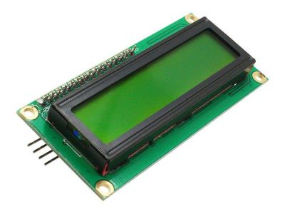

  1. LCD display screen: I added this function for the convenience of the user. The user can watch the LED blinking without looking at the computer.
  2. The LCD screen will display a complete word string at the end: This allows further usage and convenience for the user.

  3. An LCD display screen

  3. LCD:
    1. Connect VCC to 5V
    2. gnd connect to gnd (ground)
    3. SDA and SCA are respectively connected to the corresponding pins on Arduino
