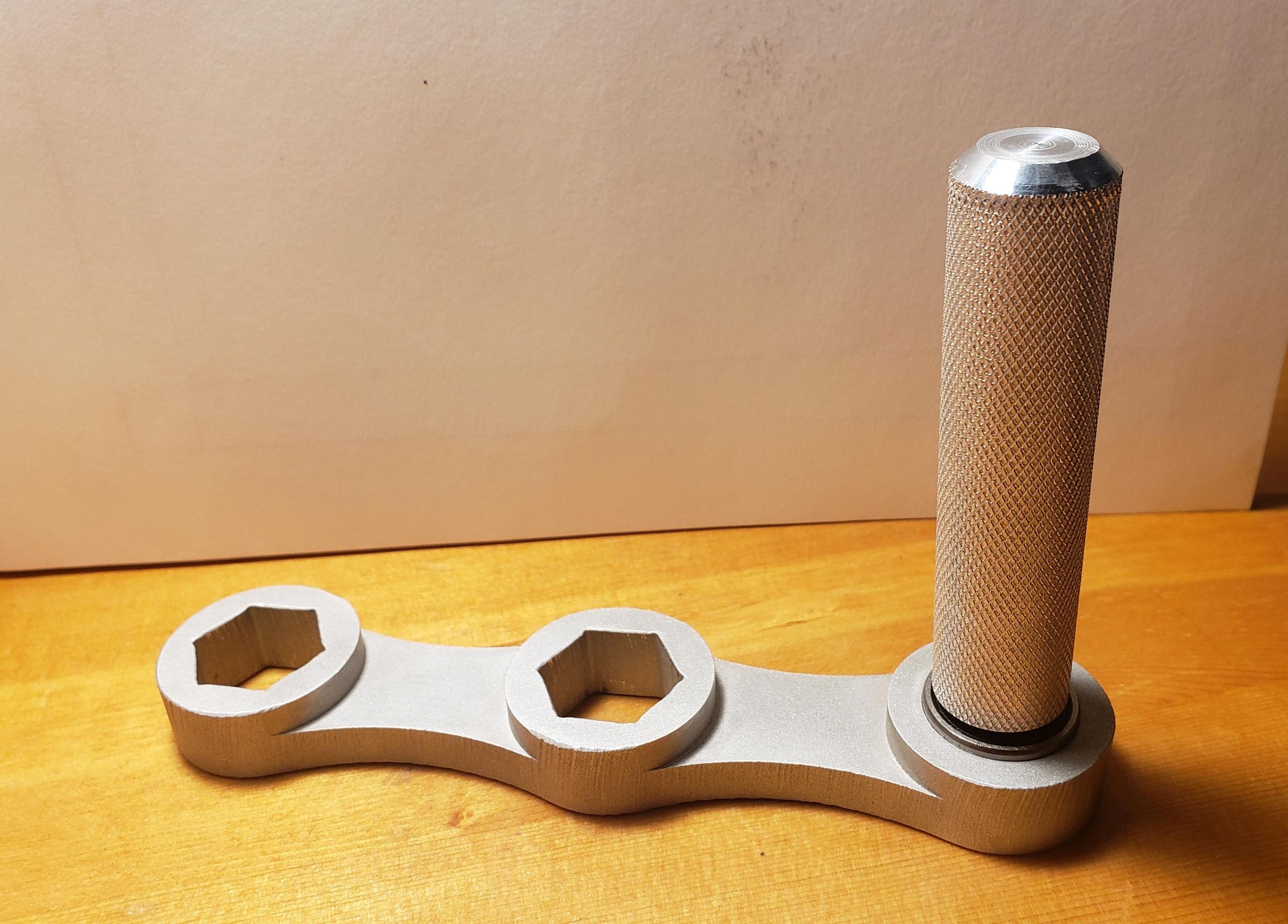

To add some weight to the case I decided to use aluminum to make the mounting plate. To manufacture the plate I used the CNC router at a local maker space. But before using the CNC I first had to program it in FusionCAM. For a more in-depth description of CAM check out my previous project making a Vice Handel here.
I first created a facing tool path using a 0.25" endmill to remove 0.125" from the aluminum plate, bringing it to the final dimension of 0.125" thick. Next switching to a 0.125" endmill, I perform a helical bore to cut out the holes for the potentiometers, and finally a slotting toolpath to cut out the profile.
Since the CNC router at the makerspace did not have any workholding available I drilled holes into the stock and then screwed it into the MDF. My speeds and feeds were too aggressive for cutting without coolant and caused the 0.125" endmill to become clogged with chips, this led to the endmill to rub more than it did cut, leaving a horrible finish.
To clean up, I took it back to my workshop and cleaned it up on a belt sander, and then used a drill press and chamfer tool to clean the holes. I then sanded the whole plate to create a uniform surface finish
