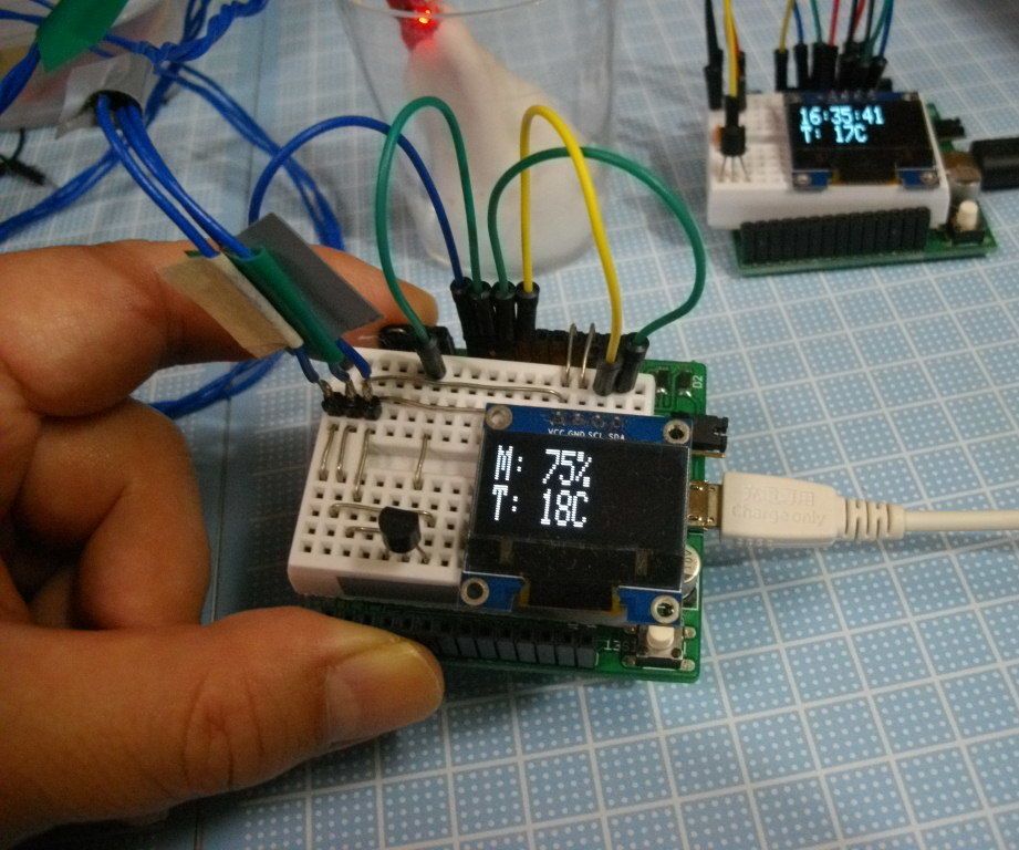

this project, esp8266 + ATmega328 use.
analog temperature sensor
, NTP Clock display possible to OLED
, and Sensor value send to Cloud Service.

Analog Sensor LM60BIZ
I2C 0.96 inch OLED display
# arduino Library:
Time: http://playground.arduino.cc/code/time
TimeLib
WiFiUdp
Adafruit_SSD1306
# Connect
A0 : analog Sensor
A4/A5 : I2C OLED 0.96 inch display
