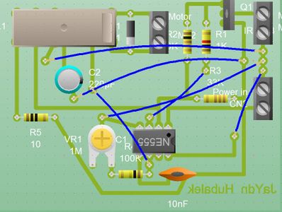

FIRSTLY THE CIRCUIT DIAGRAM BELOW R5 IS NOT 100K ITS 300K JUST A OLD VERSION.
I designed and created this circuit myself it is setup for turning off a fan after 6 minutes when the computer turns off but this can be changed if you moddify the NC and the NO pins on the relay. It should run from about 1:20sec - 6min. i realised later there waere 2 fauls, 1 due to the relay, i have discoverd that the relay is very tempremntal, when the relays power is switched off the capacitor side of the relay (common) must hit the NC (normaly closed) before the other side closes otherwise it will not begin to time and will simply switch off, i solved this problem on mine by removing the cover of the relay and bending the NC pin so it was closer to the common. The other issue was that if the trigger was switched back on druing the countdown the timing would just pause and resume as soon as the trigger was activated meaning depending on how long it had been running it would varie the remaining time.
Note: the motor can be replaced by a relay (with a diode) so this can control anything you wish,such as a delay for your car headlights or a bathroom fans to remove steam after you leave, again it is a very vercitile circuit and can be used for a variety of things.
"The PCB artwork below is mirrored for direct exposure to a PCB"
