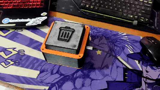

In essence, the Delete Button XL is a macropad with a single button that is configured to execute the delete command.
The objective was to design a unique or unconventional macropad with a single button that would be used to execute the delete command. This button would allow you to erase anything by simply hitting it.

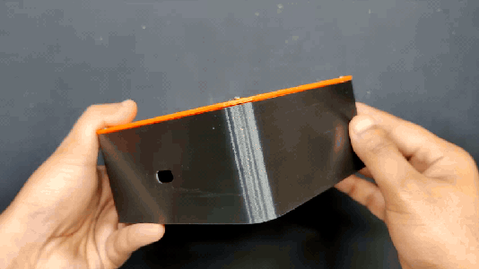

This body is designed to function and seem like a single mechanical key on a mechanical keyboard. We put four springs in the interior of the macropad, which, like the mechanical key, provides a little resistance when pressed.

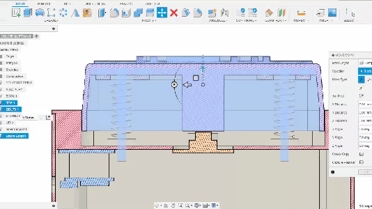

Step 1: Design

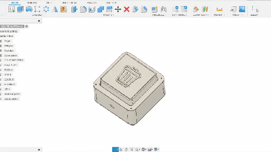

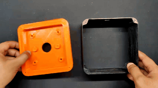

Making the 3D model for this project was relatively straightforward. First, we imported the step files of the XIAO breakout board and button PCB that were previously created for the Super NES project.
The Switch PCB was positioned in the center, and we modeled a box-like body around it that would serve as the macropad's main lower body. In order to attach the keycap to the bottom body, we utilized four M3 bolts and four springs. We also created an additional body onto which we installed the switch PCB. This section will also have four holes.
The design's operation was straightforward: when the keycap is pressed, the spring that is attached to each M3 bolt is compressed, pressing the entire assembly downward to produce a noticeable resistance.
The spring mechanism is made up of a separate part that fits into the keycap and serves as a link between the two.
The actuator knob on the keycap hits the push button and records a keypress when the keycap moves just 3 mm downward.

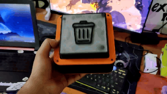

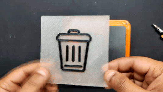

On top of the keycap, we have also modeled a Delete Logo that will be printed in two colors—black and translucent.
After the model was finished, we exported the mesh files and used Orange PLA and Black PLA to 3D print the files. This gave the finished prototype a nice dual-color appearance.

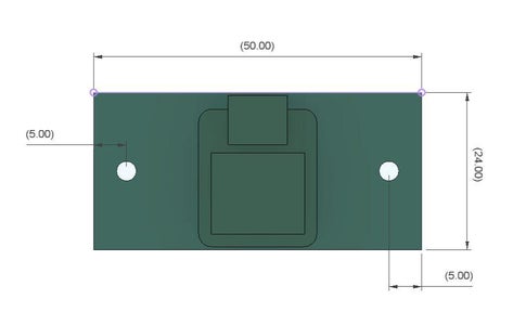

Step 2: PCB Schematic and Design

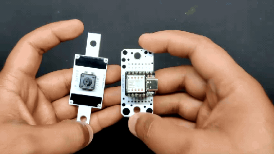

We used our previously made Switch PCB and XIAO Breakout board PCB for this project; both were utilized in the Super NES project, but let me briefly review the way they were made.

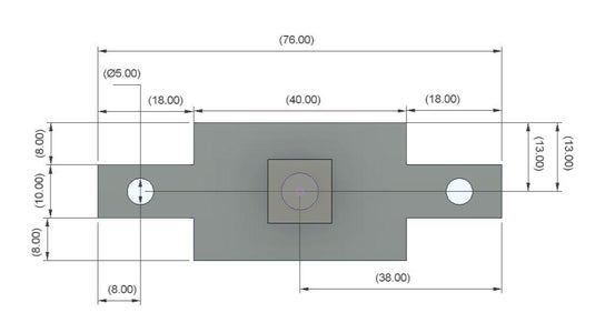

The Switch PCB is made up of a single switch with four CON1 ports, two of which are linked to one switch terminal and two to another. Furthermore, we have included two mounting holes that are positioned in accordance with the Cad file. The board's outline and the location of the switches were both taken from the CAD files.

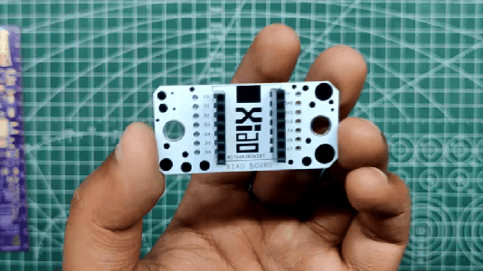

A XIAO Board and two CON7 ports, each of which is coupled to an XIAO GPIO, make up the XAIO PCB. Similar to the switch PCB, we added the mounting holes and followed the Cad files for the board shape and XIAO placement.

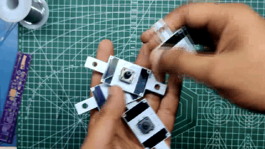

Step 4: PCB Assembly Process
  1. The PCB assembly process was basic. We began by assembling the switch PCB, which simply required a push button, which we positioned and soldered from the board's bottom side.

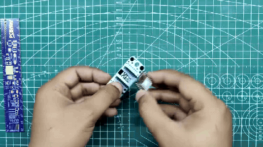

  2. After that, we begin the XIAO breakout board construction procedure by positioning both CON7 female header pins in their proper locations and soldering their pads from the PCB's bottom side.
  3. At last, we added the XIAO M0 in its place using the header pins.

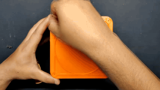

Step 5: Frame Assembly Process

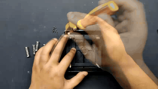

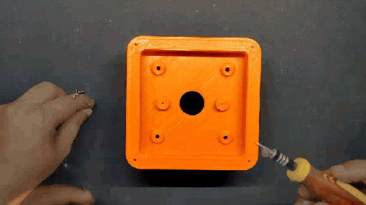

  1. In order to begin the body construction, we place the switch circuit holder part on top of the lower frame using M2 screws.

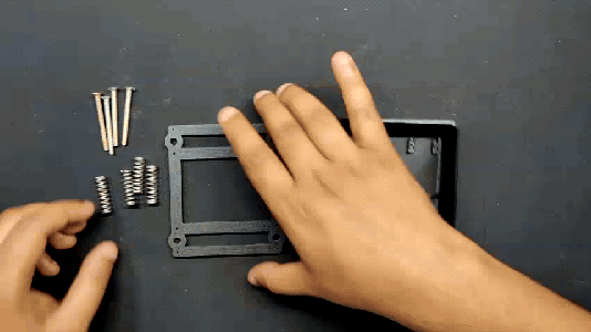

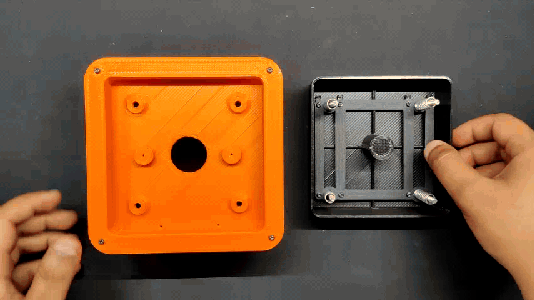

  1. The button actuator assembly, which is made up of the keycap and spring mechanism, is then prepared.
  2. This procedure begins with the installation of four M3 bolts in the spring mechanism part's mounting holes. Next, the spring mechanism part is inserted into the keycap, and the two are joined using M2 screws.

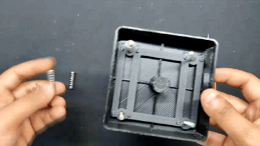

  3. Next, we insert a spring into each M3 bolt. The spring is taken from an old Anet A8 3D printer's bed assembly, and the keycap assembly is essentially made using the same mechanism as the 3D printer bed.

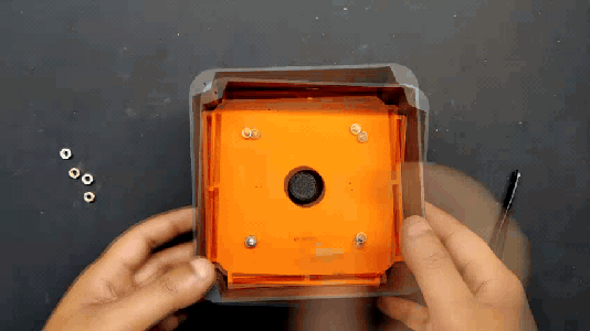

Step 7: Frame and Button Actuator Assembly

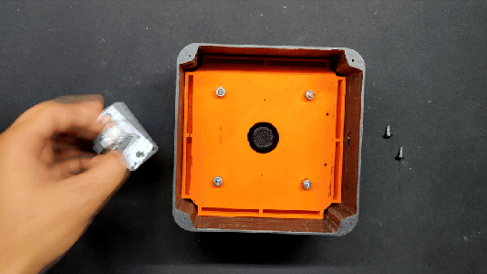

  1. By positioning the frame assembly above the keycap and allowing the bolt to pass through its four mounting holes, we are now able to connect the frame assembly with the button actuator.

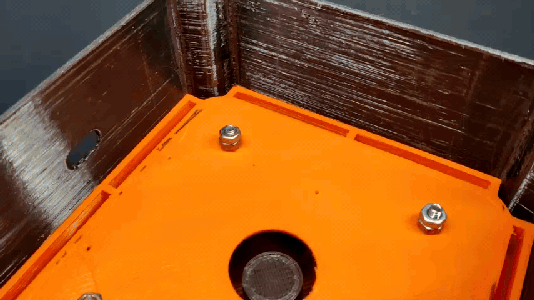

  2. Then, in order to connect the button assembly and frame assembly, we attached four M3 nuts to each M3 bolt.
  3. We added four more M3 nuts to ensure that everything was stationary and tight, and they tightened against one another to prevent them from coming free.

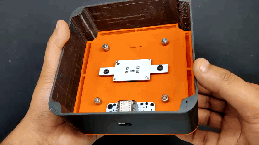

Step 8: XIAO Breakout Board and Button PCB Assembly

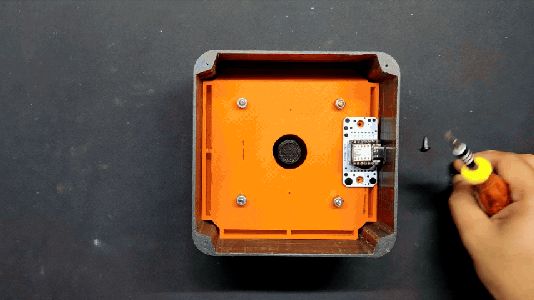

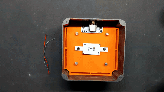

  1. Now, the XIAO breakout board is positioned and fastened within the frame assembly with two M2.5 screws.
  2. The Switch PCB is then positioned in the center of the frame assembly, and it is secured in place with two M2.5 screws.
  3. Now, both circuits are in their proper positions.

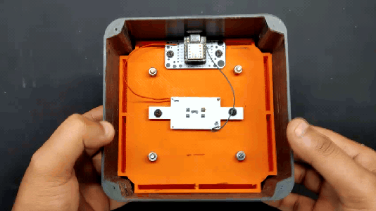

Step 9: Wiring
  1. In order to complete this project, we used a soldering iron to connect a wire between the D0 Pin of the XIAO and one of the switch's terminals.
  2. We then connected a wire between the switch's other terminal and the XIAO's GND.
  3. In essence, this configuration is a switch connected to D0 of XIAO and GND; a keypress causes D0 to be pulled down, which is recorded as a keypress.

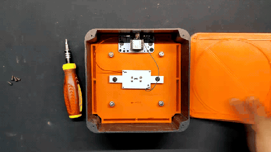

Step 10: Final Assembly
  1. We next installed the lid on the frame assembly's bottom side and fastened it there with four m2 screws.
  2. Finally, we take the dual-colored Delete Logo section and position it on top of the keycap.
  3. The delete logo is placed on the keycap after superglue has been applied on the top of it to secure it in place.

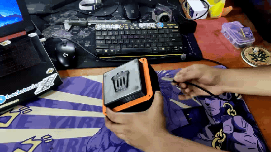

Step 12: RESULT

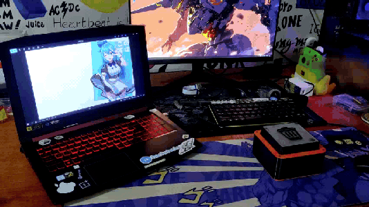

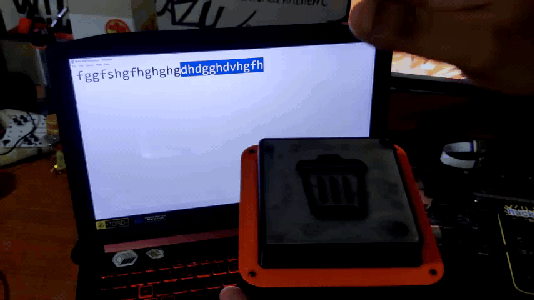

We try to delete some unwanted images from our computer by plugging in the Delete Button. Because of the spring, the configuration is perfect, and there is a tiny resistance to the keypress when using this device.
It can delete anything, including the files, images, and any selected text. It can be used as a delete macropad in CAD applications or other editing programs.
Overall, this project was finished and required no further revision.
