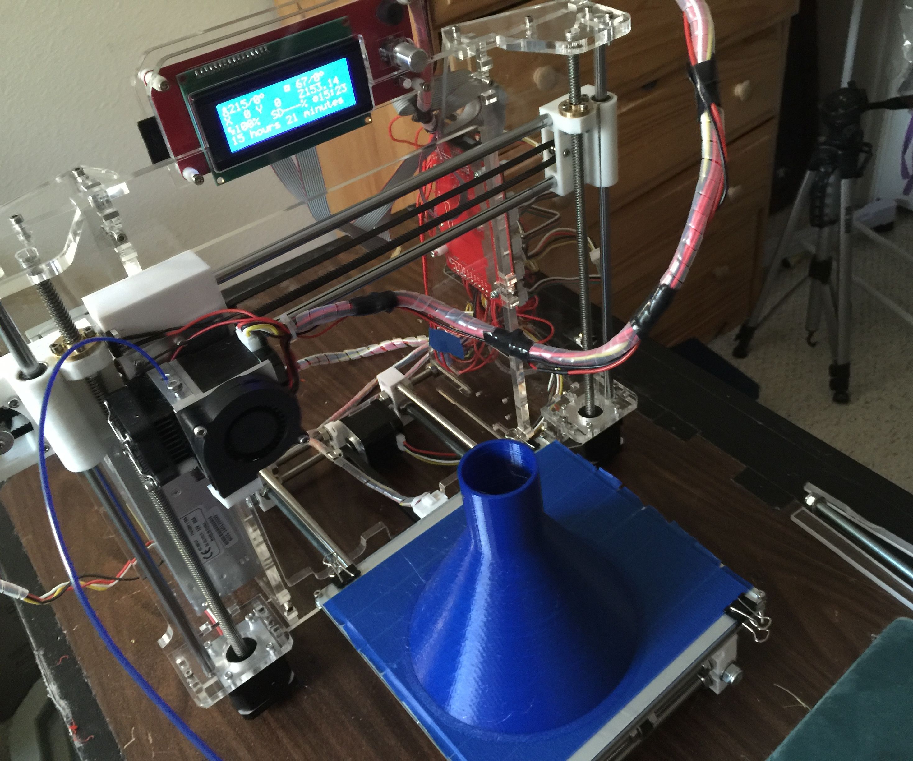

I recently purchased a Delta 3D printer kit from a Chinese manufacturer. The heated bed that came with it was thin and warped (I wish this was the only problem with this expensive printer kit!). A glass plate on top of it was high centered and could not be clipped down easily. The manufacturer sent me a replacement heated bed, but it too was warped. Realizing that I'd never get the printer to work with a warped bed, I decided to make a high quality heated bed that would not warp.
This particular printer has a 310 mm diameter print bed that is secured on printed plastic brackets, below which are the electronics for the printer. Following the instructions in this article you should be able to make a similar heated bed of a similar or smaller size.
Regardless of the type of 3D printer you are working with, this type of heated bed upgrade will serve you well. The silicone heater heats rapidly and the thick aluminum plate holds the heat well.

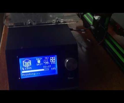

The heated bed should now be ready for printing. When printing with ABS I still apply a layer of Elmers Glue from a glue stick as seen in some of the photos.
The temperature of the top of the glass is generally within about 5 degrees C of the temperature reported by the printers control panel.
You will know when the heater is being powered because the red light on the solid state relay will be on. You can see this in action as a few bag clips (thingiverse:212117) are printed in the following video.
