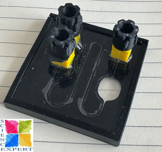

The fabrication of the microfluidic plates is initiated with the utilisation of plates that have been 3D-printed to create channels. The dimensions of these plates are precisely measured at 50x50x1 mm, with each plate exhibiting a meticulously designed profile.
In order to manufacture the requisite microfluidic plates, the following components are required:
- Double-sided adhesive, characterised by transparency and high adhesion.
- Plates with 3D-printed channels, measuring 50x50x1 mm. the dimension is chosen according to the dimension of the double-sides adhesive.
- 3D-printed inlets and outlets.
- Plates (cover and bottom) made from polystyrene, sourced from reused CD or DVD boxes.
- Commercial or home made Rubber Gaskets. The internal diameter of the rubber gasket is 6 mm.
- Epoxy glue and tube.
Step 1: Channel Plates and Inlets and Outlets (3D Printed Parts)
The medium for 3D printing is constituted by STL files. These plates are 500-micron microfluidic circuits for the channels. The plates have dimensions of 50x50x1 (H, W, T) mm. The formats are ready-to-use STLs.
The channels are categorised into three distinct families: emulsion, T-junction and mixer. In addition, two further mixer families are distinguished: simple and high density :
The STL file for the low density mixer, with 300 microns channel, is attached below. The other files are available on SciencExpert Website.
The decision was taken to utilise UNF1/4" 28G thread plugs. This standard, which originates in the USA, is most frequently employed for HPLC and GPC chromatographic tubes. The expense and scarcity of the connectors intended for use by males and females has necessitated the creation of a special design that can be printed on a 3D printer using PLA as the material. The female component is a cube with a 1/4-inch thread hole, which is affixed to the plate using epoxy glue. The male component is designed to accommodate a 6-mm external tube, which is a standard aquarium component. As illustrated below, the construction of the piece is demonstrated. The female component has been printed in yellow PLA in order to facilitate greater clarity and distinction between the female (yellow) and male (black) components.
Step 2: Plate Construction Procedure
From the 5x5x1 mm printed microfluidic plate, the position of the inlets and outlets is marked on the part that is protected by a PE sheet of the double-sided adhesive. This procedure is then repeated on the polystyrene plate, which is cut to a size of 6x6 mm.
The perforations in the double-sided adhesive tape are created through the application of heat from a soldering iron to the adhesive layer. The perforations in the polystyrene plate are produced by drilling with a 3 mm drill bit.
Subsequently, the adhesive is carefully positioned on the microfluidic plate by adjusting the housings provided for the inlets and outlets. It is imperative to avoid the formation of air bubbles, and the adhesive is compressed on the plate to enhance adhesion across the entire surface.
Once the adhesive has been adequately applied to the plate, the polyethylene sheet is removed, which protects the second side. The polystyrene plate is then affixed by adjusting the housings provided for the inlets and outlets.
It is evident that the PS plate (6x6) is of a larger dimension than the microfluidic plate (5x5). The superfluous material from the PS plate (top and bottom) is then removed using a cutter. Subsequent to this process, the final design is achieved without the outlets and inlets :
Step 3: Waterproofing of the Structure and the Rubber Gaskets Manufacture
Following the attachment of the outlets and inlets to the plate, a tube is inserted into the outlet and a M6 screw plug (M6 screws close to a UNF 1/4) is inserted into the inlets to close them.
The plate is then Subsequently, the plate is to be immersed in a bottle of water, and the impermeability is then tested by introducing air into the system.In the event that the system is not impermeable at the plate (a rare occurrence, as this has never happened in our case), the plate must be corrected.Leaks are more generally found at the interface of the female outlets and inlets and the male plugs.
It is evident that a rubber gasket is required at the interface between the male and female plugs. The fabrication of a homemade rubber gasket is achieved by utilising a used inner tube and a 6 mm diameter hole punch.
