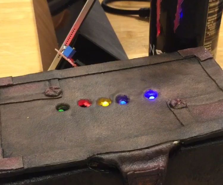

Step 5: Build-a-(demon)bear
Now it's time to build our actual bear! I bought a Teddy Scares bear online, because I thought it looking scary would make me feel less bad about cutting into it than I would with a normal bear. I was wrong.
Note: I didn't unplug any wires or anything from the Arduino and other components when assembling the hardware into the bear.
First I opened the bear with an incision in its back, and removed some of the filling to give the hardware some space. Then I opened its right arm, slid the servo in, and stitched it back up. The white servo stick(?) should only be visible when properly stitched together.
After this i poked a little hole in its eye, and slid the LED light in. I secured it with some superglue to make sure the light wouldn't budge and fall back into the head. If this were to happen when everything's stitched up, it would be a pain to put back.
This step isn't very visible from the picture, but basically what I did get an empty mini shampoo bottle (the one you usually find in hotels) and shape it this way you could easily put the hardware in it while being protected. The last thing we would want is any of the filling to mess it up.
Then I stitched it all up, left a little hole for the remaining wires to stick out to the Arduino.
I glued the ultrasonic sonar sensor on the head of the bear, I thought it kind of looked like biker goggles. (Which fits, since it's wearing a leather jacket and all).
Then I put all of its clothing back on, and tested to make sure nothing got damaged or mover around while assembling. (Beware, it may be a bit of a hassle to put the clothing back on) I also glued the bat onto the servo.
The bear was finished, but the Arduino was fully visible from the backside, and it looked bad. So I quickly sewed a makeshift backpack to put the Arduino in.
Now feel free to enjoy your teddy bear whose eyes will glow red while swinging around a bat!
