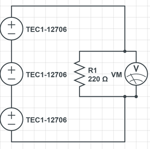

Step 4: Electronic Circuit
The way we designed this circuit is by wiring all the Peltier elements in series, to make sure the voltages the individual components generate add up. Because of the small current, there's usually no need to add an extra resistor to the circuit.
We did do this however, because our multimeter was made in the cretaceous period and has a large internal resistance.
Once you connect everything, you should be able to measure a voltage immediately, and see it rising as you spin the wheel!
