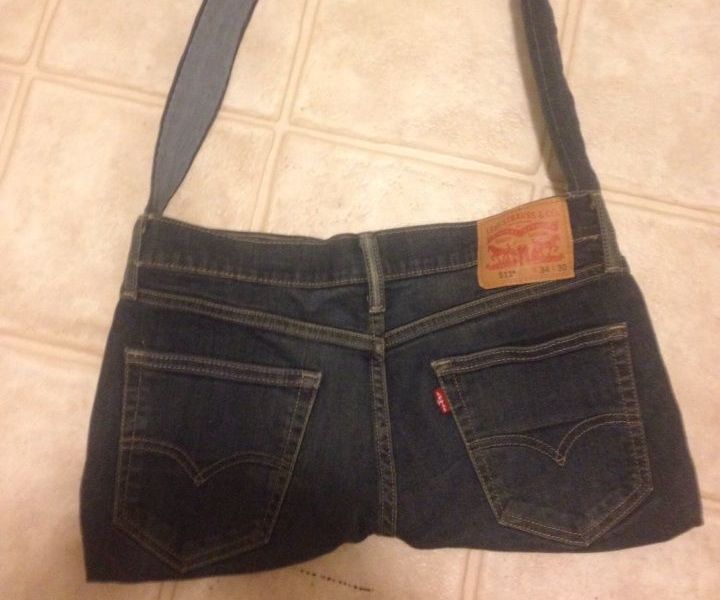

    P.S. lol you can get cheap jeans at the thrift stores and Goodwill for like a dollar or two! Lots of fabric that way.
    0
    nancy.beer.12
    Great throw by just using the denim squares. One side is clipped to give ragged look. The other side is closed seems and smooth. I incorporated pocket squares and it gave it some pizazz! Light weight and easy to fold for those trips to soccor or the beach, or keeping in the trunk for a picnic. I like it a lot more with just the blue denim. Other colors take away from the "jean" look I think.
