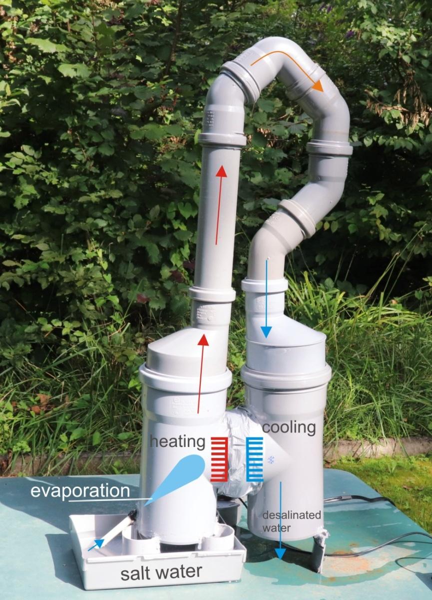

Theoretically, the H2O in our system should also evaporate from the seawater and leave behind salt. The water vapor condenses into drinkable and largely clean water. Getting water into the air consumes quite a lot of heat energy. There is a trick: we use a piezo humidifier to fire fine droplets into the air.
Step 2: The Tube Containers
We build our device with pipes from the DIY store. It consists of an evaporation area and a condensation area. Because of the Peltier element, which produces heat on one side and cold on the other, the two chambers have to be close to each other. The two are connected at the top by a cooling area made of pipes.

From the outside, a Peltier element is a ceramic plate that generates heat on one side and cold on the other when a voltage is applied. We can use both for our distillation process. The only disadvantage is that both are close together.
With the help of an aluminum body, we use the heat to convert the droplet mist into the gaseous state of water.
Step 5: Cool Down and Condense
In the cooling area of our little system, the saturated air flow touches the cooled aluminum body, the water condenses and can be collected in a container.
As our system is powered by solar energy, there are no running costs. In sunny areas, the system can operate all day long. It doesn't even have to be particularly warm - sunlight is enough.
To support the evaporation of the water, the pipes in this area can be painted black and those in the condensation area white.

I do a test with a 3.5% salt solution (35g salt/liter) that is similar to seawater.
I had the problem that I couldn't measure the salt content of the end product. So I built a small Salinity Measuring Device to be able to detect the removal of the salt.
Water input: 35 g/liter --> water output:~5 g/liter (0.5% salinity)
A first test showed a significant reduction in salt, from 35g salt/liter to ~5 g/liter. Certainly, the droplets are thrown towards the heater along with the salt, a few salt droplets find their way towards the condensation area.
The result is brackish water and still not fresh water, but it's a great start!
