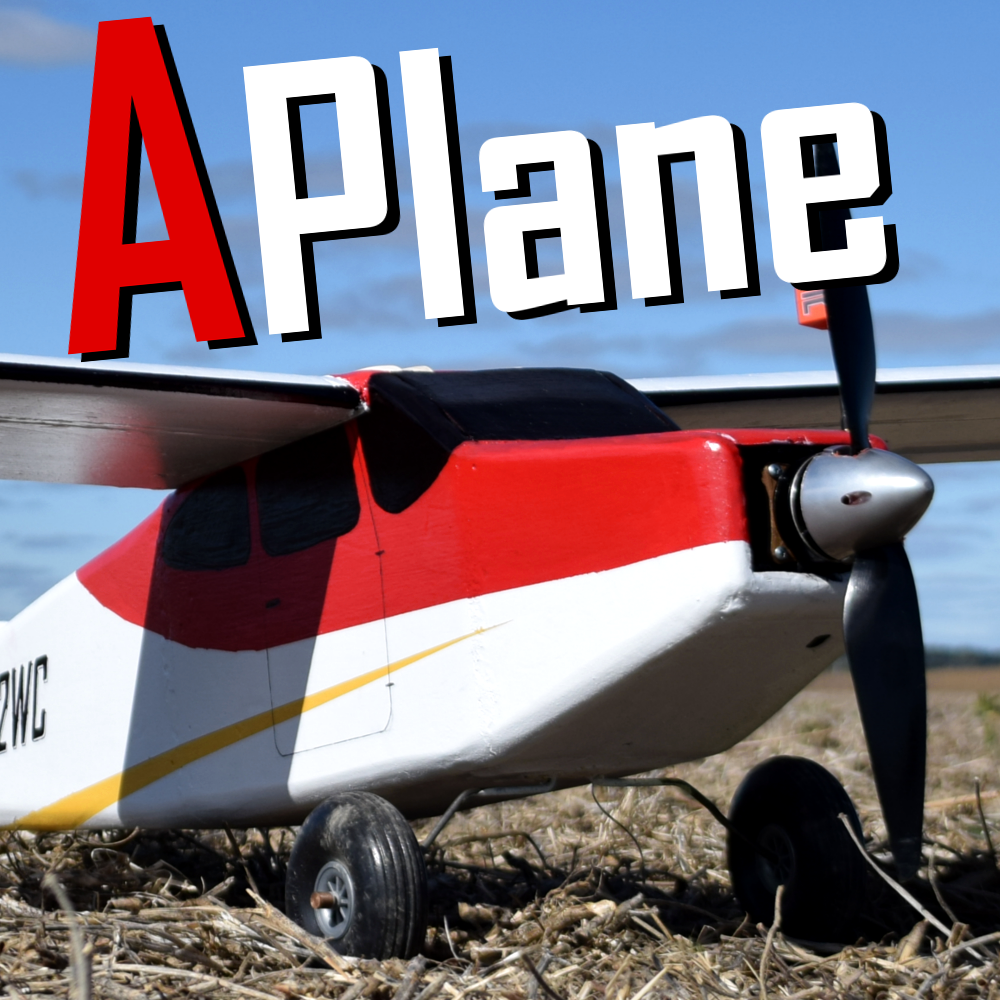

Here, I will show you how I made my twin motor RC airplane with a 75in (6.25ft) wingspan. These instructions will show you the basic ideas you need to think about and do when designing and building any RC Airplane.

The fuselage can be any length you want (to a certain degree) as long as you get the center of gravity right. While drawing out your model, just make a fuselage that makes the plane look good.
I made my fuselage 52in long and 7in wide by 7in tall. I was designing my plane to be a cargo plane, so it was a bit large and boxy.

Step 19: Maiden Flight
Now its the moment you've been waiting for. Time to see if your calculations and designs were correct. Before you maiden your new plane, you should do a range test, to ensure you have a strong radio signal. (Range Check is a mode you put your transmitter in that reduces the power to simulate as if the plane were really far away.) Many transmitters are different, so check your manual to see how to do this. Once in "Range Check" mode, walk in a large circle around your plane while moving the controls. Make sure that you always have control over the plane.
After this, your ready to fly! Make sure you have a fully charged battery, check the CG one last time, and just go for it! Throttle up to full power, and pull back on the elevator. Expect the plane to be unstable and be ready for some aggressive controls.
