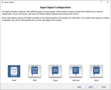

Step 11: Librepilot Software Configuration
The CC3D flight controller comes with pre-installed OpenPilot firmware. This firmware needs to be configured to meet your quadcopters need.
You'll need a mini-USB cable to connect the flight controller with your computer. And after downloading the software you can configurie the quadcopter using the Vehicle Setup Wizard.
Don't forget to remove all propellers before proceeding.
Configuring is very easy.The hardest part was finding the required software, because the Openpilot.org website isn't accessable. After a while I found out why (OpenPilot wiki): OpenPilot was a Free software unmanned aerial vehicle project for model aircraft aimed at supporting both multi-rotor craft as well as fixed-wing aircraft. OpenPilot was discontinued and reinitialized as LibrePilot.
You have to download the required software from the Librepilot website.
Before proceeding it's time to bind the transmitter and receiver together. Place the supplied bind wire to the (shown in the first image) 3 connectors which are labeled B/VCC. Turn on the transmitter, and press (and hold) the bind key. Connect the battery with the quadcopter. This will give power to the flight controller and the receiver. The led indicator on the receiver starts flashing. Wait until the led stops flashing. Now remove the battery and turn off the transmitter. Don't forget to remove the bind wire.
Start the "Vehicle Setup Wizard". Before configuring the flight controller, the firmware must be updated. Choose to erase all settings, because this is a new configuration. After upgrading it's time to identify the board. This is an Openpilot CopterControl 3D board (this is automatically detected). The receiver uses PWM (pulse-width modulation) signals.
This flight controller can controll different types of vehicles. Choose the multirotor. I couldn't find the proper value for the Emax Simon ESCs: I use the default value (Rapid ESC).
This is a "Quadcopter X" configuration. Take notice of the direction of rotation of the motors These should match your quadcopter.
This ends the first part of the configuration.
Place the quadcopter on a flat (leveled) surface. The next step starts with calibrating the accelerometer and the gyroscope.
The ESCs need to be calibrated to use the full throttle range of the flight controller. Follow all 7 steps.
After calibrating the ESCs it's time to calibrate the output levels. Follow the instructions and move the slider until the motor just starts to spin stable. You can calibrate all motors at the same time, if you want. Make sure the motor rotates in the corrospending direction. If the motor spins in the opposite direction, you have to change 2 out of 3 wires between the motor and the ESC.
This wizzard only sets the initial tuning parameters. Choose between the Generic Quad X (Q250) or the ZMR250 (Chinese QAV250 clone). Finally it's time to save the configuration.
This is the basic setup of the quadcopter. There are more advanced options. But this is enough for the first flight experience.

Use the LibrePilot software to setup an "Hexa X" multirotor. The flight controller should be facing towards motor 6 and 1 (motor 1 is marked with orange paint).
