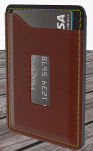

About the 3D configurator
  • Is a web based interactive viewer.
  • You can modify the design, colors, leather type, thread edges, etc. (which updates in real time).
  • It may require some graphic memory, so if it slow just try to make your browser window smaller, that way the resolution will be lower.
  • The mobile version need some improvements. (will work on it)

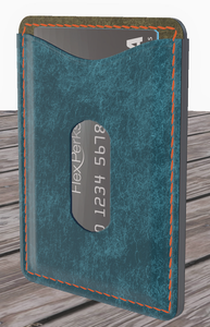

Step 1: Design It.
Visit https://www.raulreyes3d.com/vch02a3d
In the left toolbar you will find styles, colors, leather types and even custom stamping.
After you finish your wallet, there is a button to save it as an image. so you can compare it with another variation you may like.

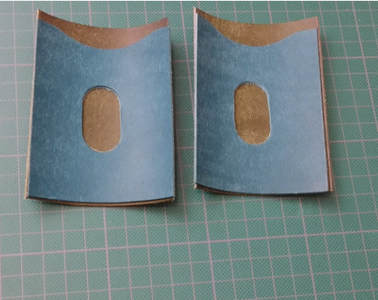

Use the 3/4" hole punch to create 2 holes as the template shows, then join them.
You will need 4 pieces: 2 middle panels and the card slots.

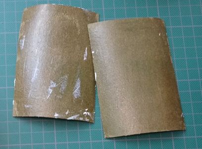

Step 4: Glue Middle Panels
Apply glue to the flesh side of both middle panels, wait the glue to dry a bit and then join the pieces.
Step 5: Glue Slots
Using your knife, scratch the grain side of your middle panels and apply glue.

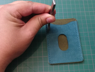

Step 6: Marking and Preparing for Stitching
Use the Leather compass to mark the stitching lines, i use a distance of 3mm or 1/8".
Using your chisel and mallet, mark the stitching holes (or punch through the leather).

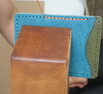

Step 7: The Relaxing Part, Stitching.
For this card holder you will need 50" of thread (1.20 m)
There are different methods of stitching, some of them doesn't require a stitching pony.

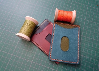

Step 8: Finish the Edges.
spread tokonole or gum on the edges, then create friction by running the canvas (or slicker) back and forth across the edges.
