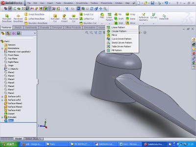

draw a circle big enough to fit the three blades. Next use 'Features & 'Extrude Boss/Base' in both directions. The 'Fillet' or 'Dome' the front side (the same side as the flat side of the blade).
Using 'Circular Pattern' select the 'Bodies to Pattern' i.e. the blade to make our 3 blade turbine we are all familiar with.
