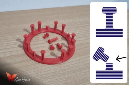

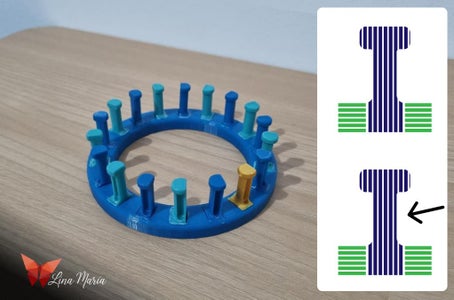

I previously experimented with 3D-printed knitting looms in different shapes—circular, rectangular, and figure-eight. However, the pegs kept breaking under tension. I tried reinforcing them with adhesives like methylene chloride and super glue, but they still snapped.
Realizing that the issue was due to how 3D-printing layers interact with tension, I decided to redesign the pegs so that the layers aligned vertically. This way, lateral force wouldn’t cause breakage.
My new design proved successful, and now I'm excited to share this custom-made blue knitting loom with you!

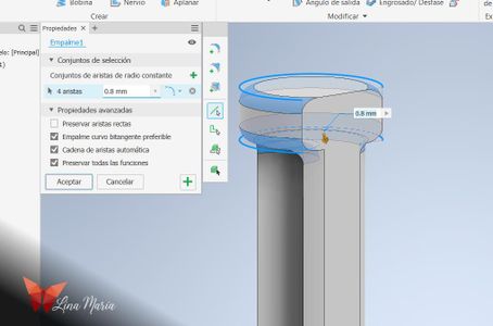

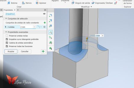

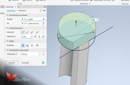

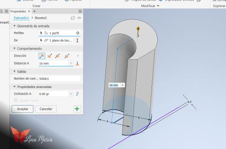

Step 2: Designing the Pegs
I modeled the pegs in Autodesk Inventor, ensuring they had a flat base for better printability.
  1. Started with two overlapping circles (like a crescent moon).
  2. Extruded the shape.
  3. Added another larger circle on top and extruded it.
  4. Smoothed the edges

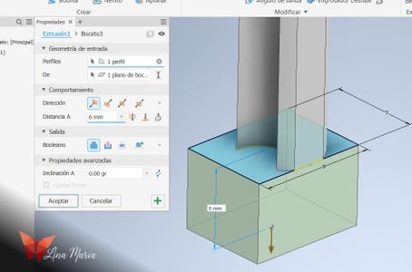

  5. Added a rectangular base for attachment.
  6. Finalized the shape with additional curves.

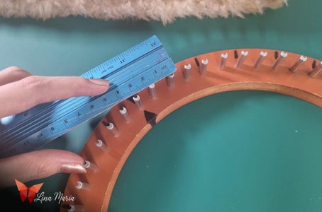

Step 3: Measuring the Loom and Hat

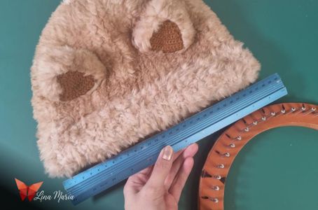

Previously, I made a wool hat using a circular knitting loom. To determine the peg spacing for my new loom, I measured:
  1. The peg spacing on my old loom.
  2. The total number of pegs.
  3. My hand width for the fingerless gloves.
Using this data, I calculated the required number of pegs using a simple ratio.

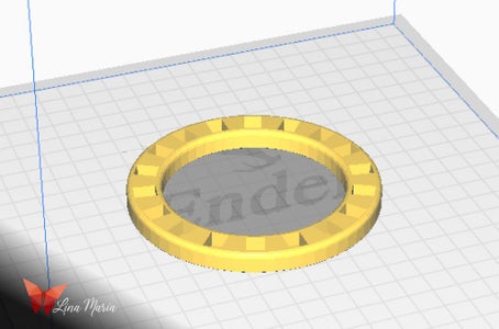

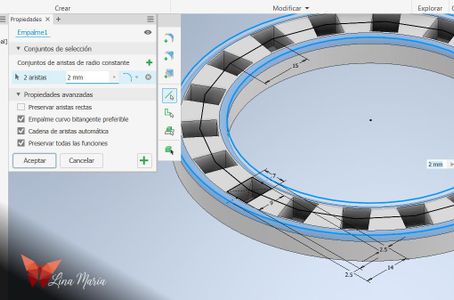

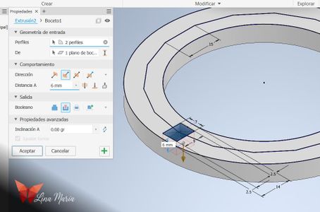

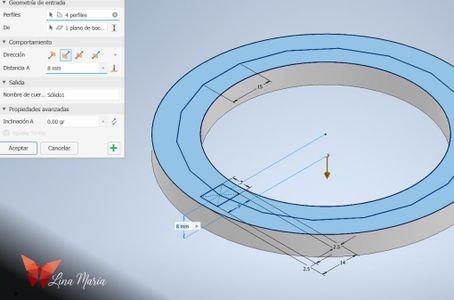

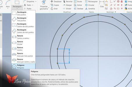

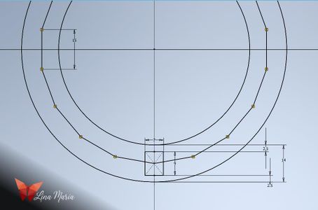

Step 4: Designing the Loom Base
  1. Created a polygon with 18 sides (based on my peg calculations).
  2. Set the side-to-side spacing to match my old loom (15mm).
  3. Drew a rectangle matching the peg’s base size and placed it at one of the corners.
  4. Added two concentric circles around the polygon for structure.
  5. Extruded the circles and created a hollow extrusion for the peg slots.

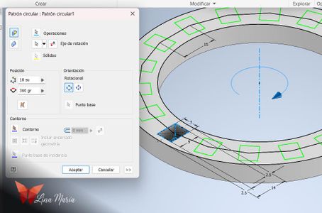

  6. Used the circular pattern tool to repeat the peg slots 18 times.
  7. Smoothed the top edges for comfort.
This method can be adapted for any loom size or shape, including square or figure-eight looms.
Step 5: Printing the Loom Base
Printed the base in one piece for better stability.

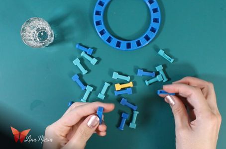

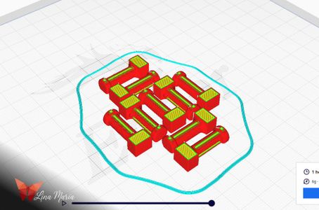

Step 6: Printing the Pegs
Printed the pegs in sets using three different colors (9 blue, 8 green, 1 yellow). The color-coding helps keep track of stitches and rounds.
In my old wooden loom, I had to mark sections with a marker, but this new method makes counting stitches much easier.

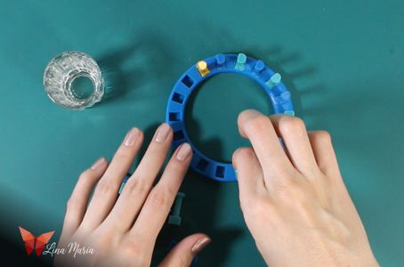

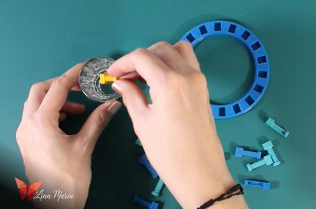

Step 7: Preparing for Assembly
Poured a small amount of Methylene chloride into a small glass container for easy application.

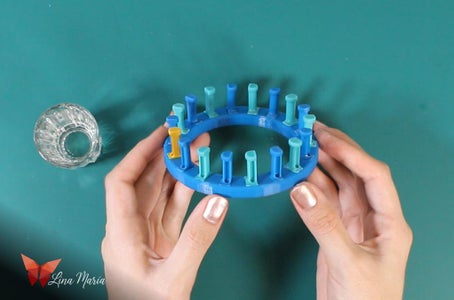

Step 8: Assembling the Loom
The base of each peg was dipped into the adhesive and inserted into the loom base, alternating between green and blue pegs. The yellow peg serves as the starting point.

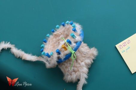

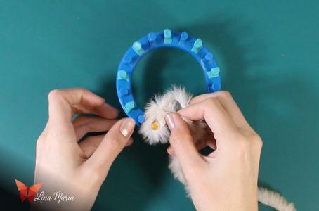

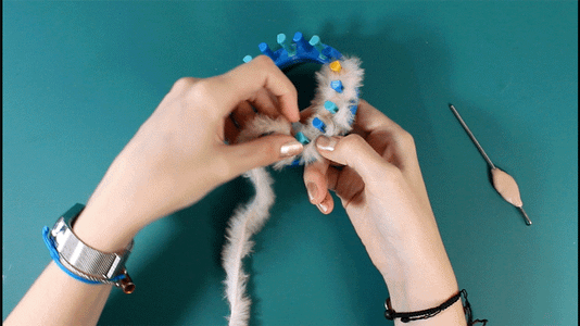

Step 9: Starting the Knitting Process
Although this tutorial is about making the loom, here’s a quick rundown of the knitting process:
  1. Tie a slipknot and place it on the yellow peg.
Step 10: Wrapping the Yarn
Wrap the yarn around each peg in a continuous loop.

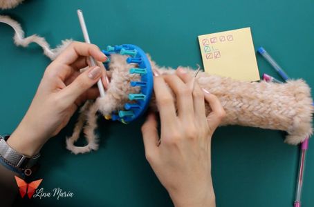

Step 11: Knitting the Stitches
I used two stitch types:
  1. Basic stitch: Loop the yarn around a peg and pull the bottom loop over it with a loom needle.
  2. Ribbed stitch: Place the yarn in front of the peg and pull the bottom loop over it.

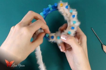

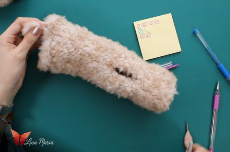

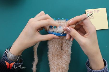

Step 12: Keeping Track of Rounds
After 20 rounds doing exactly the same, I inserted a thick green yarn marker to track my thumb hole. Then, I alternated knitting one round to the right and one to the left to create an opening.
Step 13: Finishing the Glove
  1. Completed 20 full rounds.
  2. Knitted 7 additional rounds with the thumb hole.
  3. Finished with 10 more full rounds.

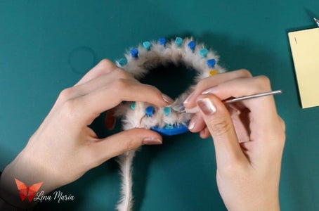

Step 14: Binding Off
Using a crochet hook, I pulled each stitch over the next to create a chain-like edge, then tied a final knot and tucked in the excess yarn.

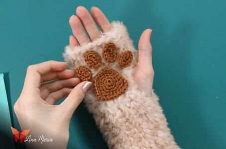

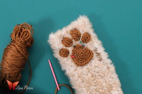

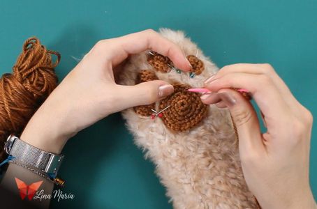

Step 15: Adding the Final Touch
or a cute detail, I crocheted small paw prints and stitched them onto the gloves.
