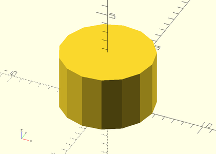

First, let's make the instance. In this case, it is a Lego Duplo button with diameter d1 and height.
d1 = 9.4;         // Duple button's diameter (mm)
height = 4.5;       // Duplo button's height (mm)
thickness = 1.2;  // Base's thickness (mm)
cylinder(height+thickness,d=d1);

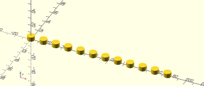

Now, to make an array in X direction we need to define the number of instances n as well as the distance between 2 instances. Adding a for loop as a function of n and deltaX will give us all the center points of all the buttons.
deltaX = 16;    // Center distance between 2 buttons X(mm)
n = 12;      // Number of buttons
for(i =[0:n-1])
  translate([i*deltaX,0,0])

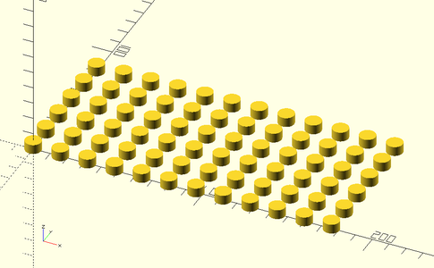

So that is how you make a linear array in X direction. If you want to make a 2D array in both X and Y directions, we need to define the distances as well as the numbers of buttons in each direction. There are more parameters such as numbers of rows, columns, and the distances deltaX, deltaY. We will need another for loop for Y direction.
deltaY = 16;        // Center distance between 2 buttons Y(mm)
row = 6;            // Number of rows
col = 12;           // Number of columms
for(i =[0:col-1])
    for(j=[0:row-1])
        translate([0,j*deltaY,0])

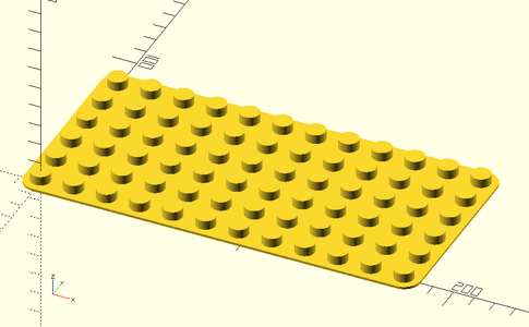

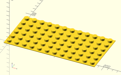

The last step is adding the base for these buttons. You can simply use the cube function
translate([-deltaX/2,-deltaY/2,0])
  cube([col*deltaX,row*deltaY,thickness]);
Or to be more beautiful, fillet all the square corners of the rectangle base with a fillet_radius of deltaX/2
fillet_radius = deltaX/2;
points = [ [0,0,0], [(col-1)*deltaX,0,0], [0,(row-1)*deltaY,0], [(col-1)*deltaX,(row-1)*deltaY,0] ];
    rounded_box(points,fillet_radius,thickness);
module rounded_box(points, radius, height){
    hull(){
        for (p = points){
            translate(p) cylinder(r=radius, h=height);
Using this code, you can make the Lego Duplo build plate at any size you want.

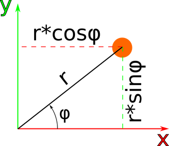

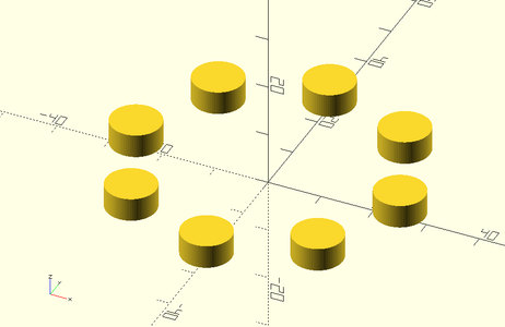

Now let' talk about circular pattern. Like in the coaster photo, instances are distributed on a circle. To understand this, let's have a look at the polar coordinate. Each point in the space is defined by the parameters radius r and the angle phi. Basically, we need to translate this polar coordinate of r and phi into the x and y Cartesian coordinate because we want to present them on openSCAD. The translate equations are x = r*cos(phi) and y = r*sin(phi)
d1 = 9.4;           // Duplo button's diameter (mm)
n = 8;              // Number of instances
delta = 360/n;		// Angle between instances
r= 25;
for(i =[0:n-1])
    phi = i*delta;
    translate([r*cos(phi),r*sin(phi),thickness])
        cylinder(height,d=d1);

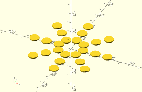

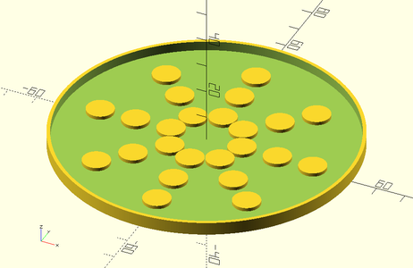

If you add another for loop, you can spread the pattern along r. For example, I add another for loop in which I have the j parameter of [0.5, 1, 1.5]. Then I multiplied that j into the radius r so basically I have 3 values of the radius r
for(i =[0:n-1])
    for(j = [0.5,1,1.5])
        phi = i*delta;
        translate([j*r*cos(phi),j*r*sin(phi),thickness])
        cylinder(thickness,d=d1);
Now we have the three circular patterns over the r. Each of them has eight instances on it.
The last step now is adding a base to have a coaster for example.
difference(){
    cylinder(height,d=4*r+2*thickness);
    translate([0,0,thickness])
    cylinder(height,d=4*r);
